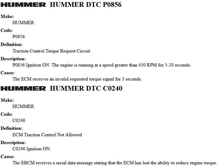

The codes I read were P0856 and C0240. I had a friend look at it as well, he took a video of whats going on as well as some of the attempted fixes. Nothing appears to work. Has anyone seen this happen to their own and resolved it?

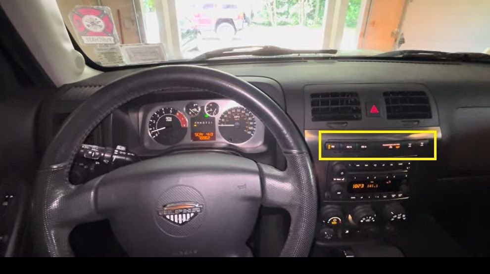

https://www.youtube.com/watch?v=yYVVv8I4pl4
Pull & clean the TC switch board/connector/contacts
