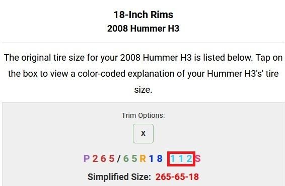

Nice choice! Either 1 since both are above OEM LR spec(112). Compare load ratings:

P, LT rates are useless.
Let me add many years of experience/knowledge. LR(Load Rating) calculated should be able to hold the CURB WEIGHT & PAYLOAD on 2 TIRES!
H3X Curb weight:4,700 lbs.Maximum payload 1,150 lbs. OEM P-METRIC LR>>112x2=4938lbs (WEAK)
Upgrading P-METRIC to LR>>>116x2=5512lbs.
574lbsX2 or 1148lbsX4 Upgrade from OEM!
On a side note, I roll with LR>>122x2=6614lbs, traveled many miles with heavy loads never had a problem with my tires.
Tire buying comes down to the user's needs! No OverLoad Go P-Metric=Save$OnFuel

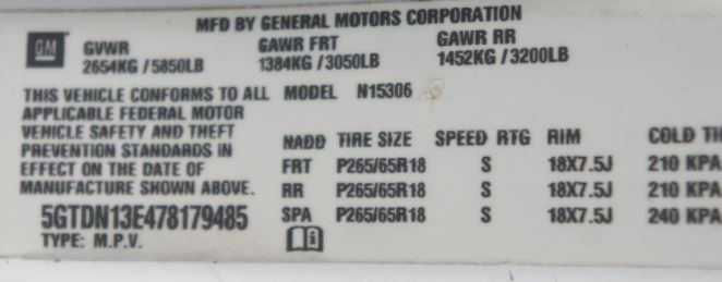

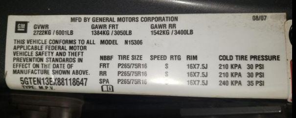

Guess the H3s without the Adventure/Offroad Package specify passenger (car) tires. I never knew.
We have owned 7 different H3/H3Ts not one has been a NON- Adventure/Offroad Package.
I would stick with the rating that GM put on from the factory if replacing with the same size.
If you are changing the tire size, going to use it Offroad or travel a lot of gravel roads go with an LT.
H3 BASE - 16" wheels
H3X - 18" wheels
