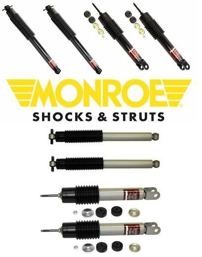

The Monroe rears were just delivered.
One is light gray and the other + fronts were black.
All were purchased from Advance Auto
Old Jul 19, 2020 | 02:20 PM
Posts: 9,024
Same shock black or gray, as long as you have the part #s 911527 & 911528
Old Jul 19, 2020 | 02:23 PM
bassackwards's Avatar
Joined: Jun 2020
Posts: 112
We could live with either color on the rear but not one of each. That would be weird.
Old Jul 19, 2020 | 02:34 PM
Posts: 9,024
Oh, hell no... call advance immediately and tell them to match the shocks!!!!!!!!!!!!!!!!!
