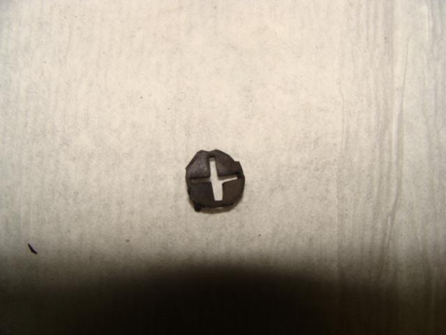

I only had to remove the passenger side, side dash panel to access the tube (just pull it outward, held in with clips). The drivers side, I just reached up under the dash to remove. Worked for me, has been over a year and been through alot of rain/melting snow/car washes, still no leak inside!.. The key to prevent any further blockage: cut the X out!

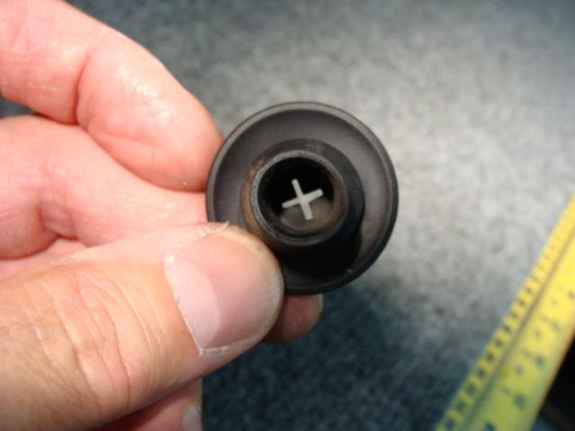

When I did mine, I dropped the passenger side grommet trying to put it back in. Its still in there somewhere. I had to go through a dealership and order a whole new drain assembly (only $15) with all the hoses just to get a new grommet. With the second one I had learned my lesson; I tied a slipknot around it with some fishing line, so that when I dropped this one (which I did, its tight in there!) I could just pull it back out. After I got it in, slipped the fishing line off and reattached the drain hose.

I pulled out the grommet which as quite easy - I thought it was going to be like a cork
The little X or + in the center of the grommet was like mud. I didnt have a 3/4 inch drill but I had some sharp scissors
I opened them up like a V and put the gromemr unto one of the blades and spun it
It cleared the opening completely

I pulled out grommet and it was gunked up too
I removed the X by putting it on 1 blade of the scissors and spinning it
