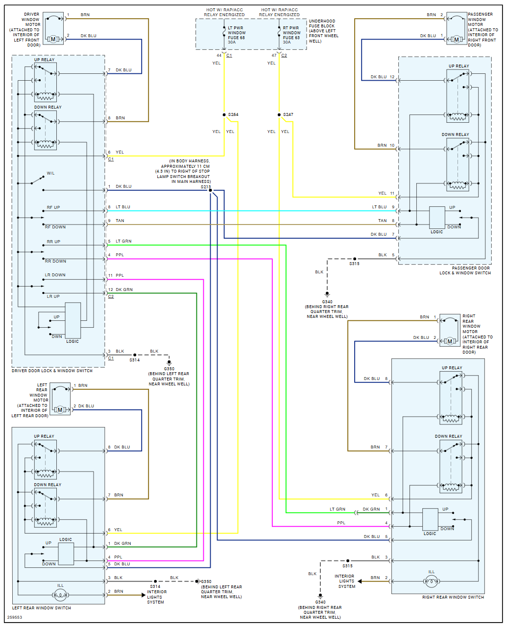

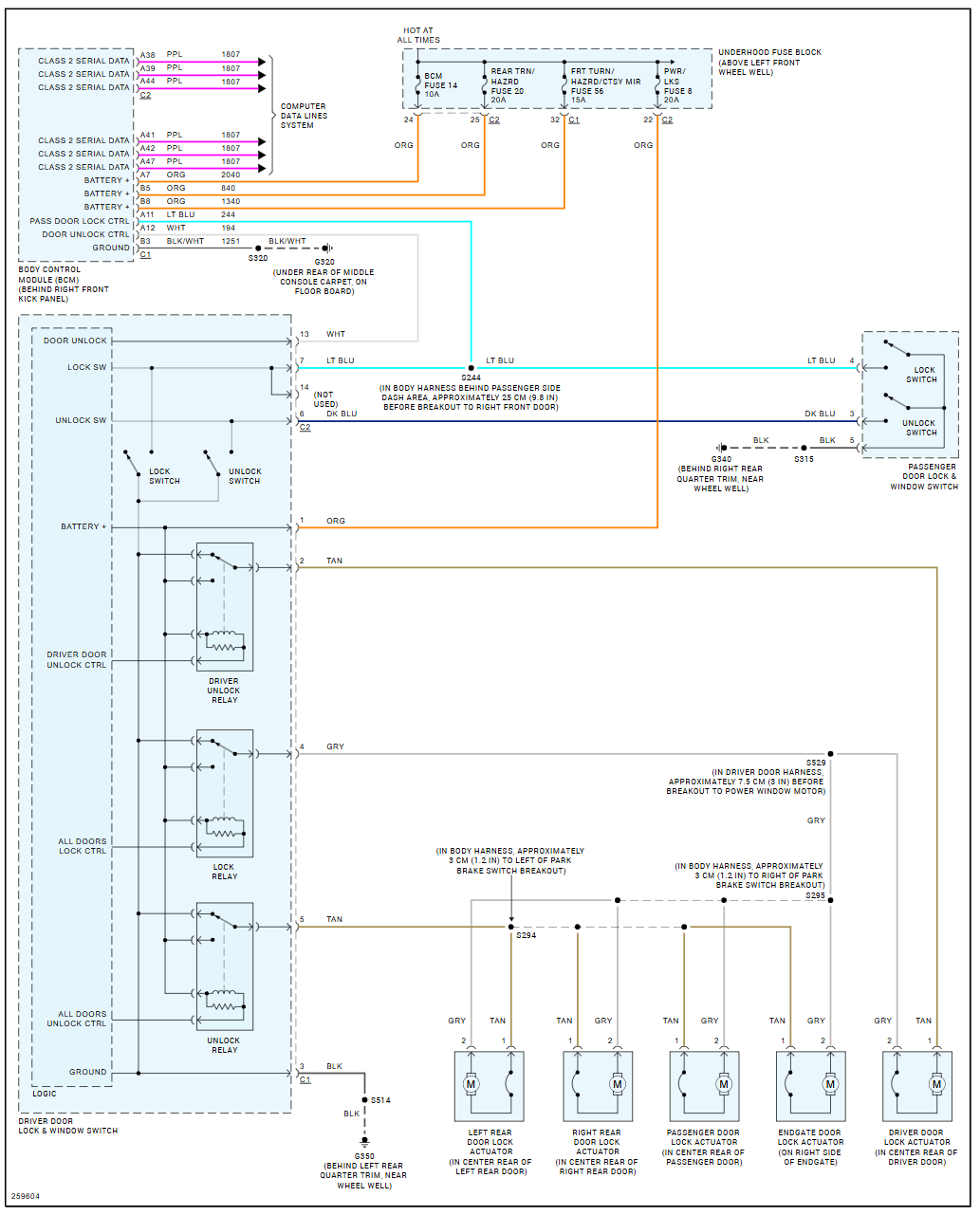

Old Jul 28, 2025 | 02:02 PM
skilescm's Avatar
Joined: Feb 2025
Posts: 36
If your driver door lock switch has a short in it, that could be your cause. Locks are hot at all times. Here are the schematics for the door locks and windows.
Also, if the driver lock and window switch has problems, it could be preventing it from sending power to the other doors.
