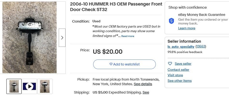

By the way gm#15286624 looks identical to the part I received. It was part#51532 6624 (stamped on the part) to a tee. I ordered 15929237. So, unless the bolt spacing is different on that part there the same.
Does it look like this?:
Old Sep 5, 2023 | 07:42 PM
  #33
Happy Hummer's Avatar
Posts: 1,656
From: Wisconsin
Yes, That is exactly what I ordered from that vendor.

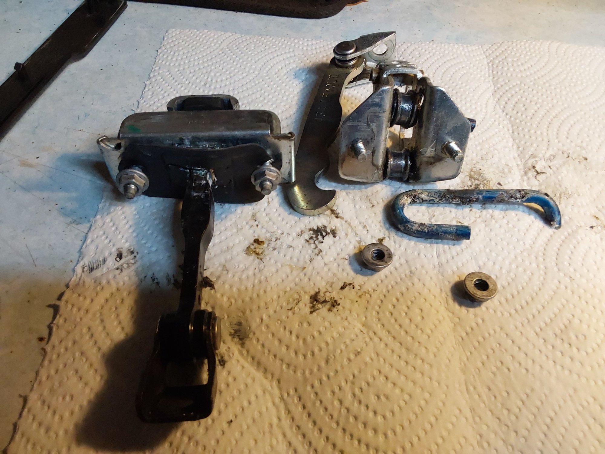

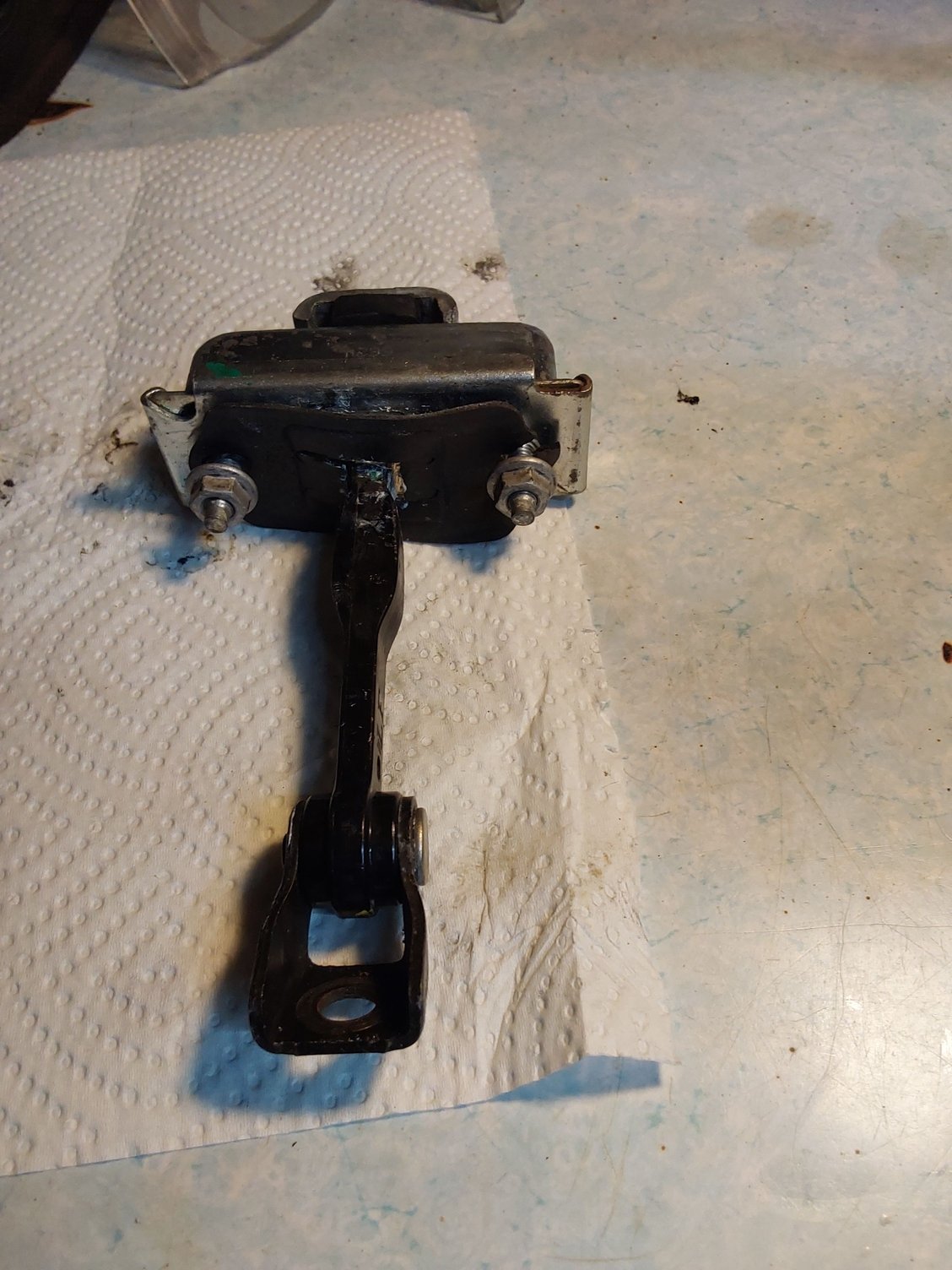

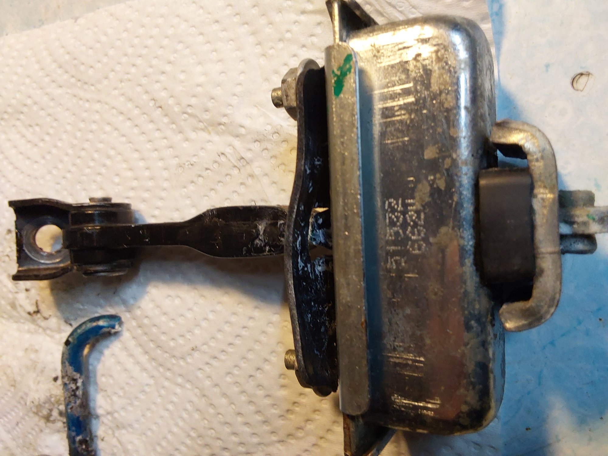

Here are some pics.
51532 6624 2 1/8 on center
434 1 3/4 on center
434
434 & 51532 6624
Old Sep 5, 2023 | 08:13 PM
  #38
Here are some pics.
434 1 3/4 on center
434
434 & 51532 6624
You have a 1st design(2006) on your 2007? The 2nd design was installed from 2007-2010, is there side movement on the mounting bolts on the one you received?

  #39
Posts: 1,656
From: Wisconsin
Naw! sadly it is stud welded in place. The holes in the door are very small and NO slotting for up or down adjustment.
Thank you by the way for hanging in there with me its appreciated. Man some times the vendors don't make this easy.
Old Sep 5, 2023 | 08:39 PM
  #40
Contact the seller and ask for a refund. That part looks exact to a 2007 H3(2nd design), yet you removed a part from a 2006 H3(1st design). After research BOTH (1st & 2nd design) fit 2006-2010 H3.
