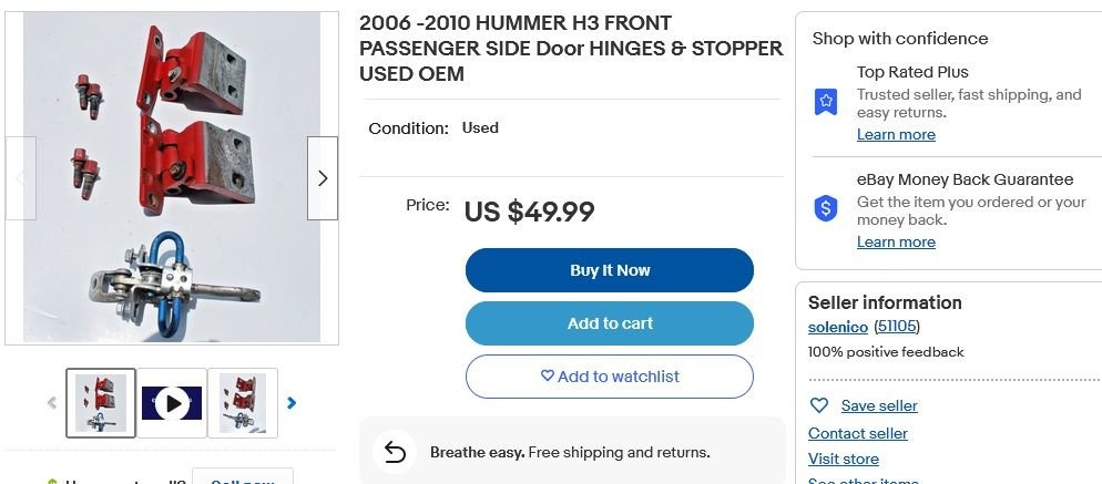

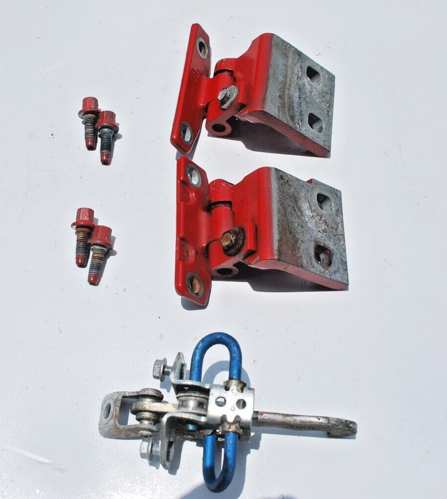

I get home from business today and there is a package waiting with the supposed correct door check for an 07 Hummer H3. I mean it is listed as the correct part on multiple sites. Also, checked it with other forum members before ordering this one. Part # 15929237
Of course after all the leg work to order the damn thing, it is completely incorrect. UGh! Damn damn damn! Lol!
The correct part is Hummer H3 Part# 434 (02207B)
Like in the pic below... But good luck finding this damn thing. Mean while my door is without the door check and cant drive because door is ripped apart.
Ebay lists 435 rear door checks. That will not work. Is the 434 (02207B) part got another part number?
Can it still be bought brand new? I'm quickly growing pissed off at Hummer/GM for just abandoning these vehicles... It gets worse every year!

WTF!
You are showing a pic from an eBay listing? 2006 -2010 HUMMER H3 FRONT PASSENGER SIDE Door HINGES & STOPPER USED OEM

Yes, lol that is the only pic I could find of this bizaro part. I'm specifically asking can the part in the pic still be purchased new. The answer is impossible to find because every d@mn place I look on the web (even gm, gmc etc. web sites show the other part I ordered ). I've have hit my breaking point with this F'n truck lol! I luv my Hummer but right now having a luv-hate moment.
I didn't just want to buy this **** in the pic if I could get it under another part #.

That's the 1st design (15286624) only lasted 1yr in production. Use the 2nd design you received!

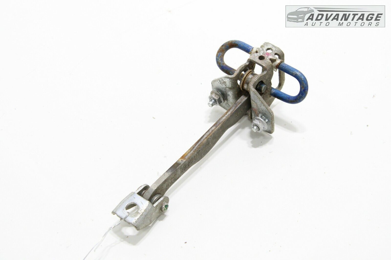

You cant the bolt pattern and wholes don't match. It will not fit lol! The part I ordered is just wrong in every way. But the correct part listed with vendors.
By the way gm#15286624 looks identical to the part I received. It was part#51532 6624 (stamped on the part) to a tee. I ordered 15929237. So, unless the bolt spacing is different on that part there the same.

GM never changed H3 doors/mounts/etc!
