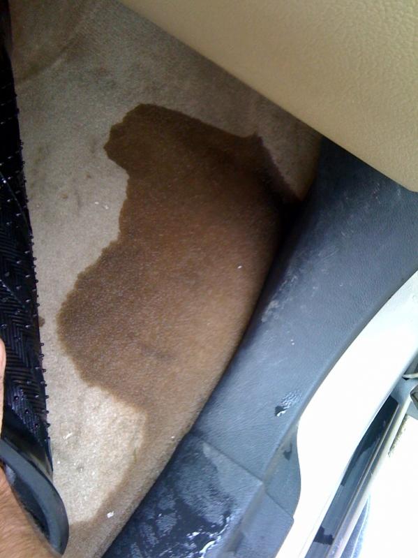

Here's what I woke up to this morning. Not wet by the headliner or onstar mic but front seat all the way to the rear is wet trying to dry it out. Any suggestions how I can get this dry? Ive been shopvacing it for hours it seems. Pulling carpet out an option?
Attached Thumbnails  Does/Did your sunroof ever leak?-photo.jpg
