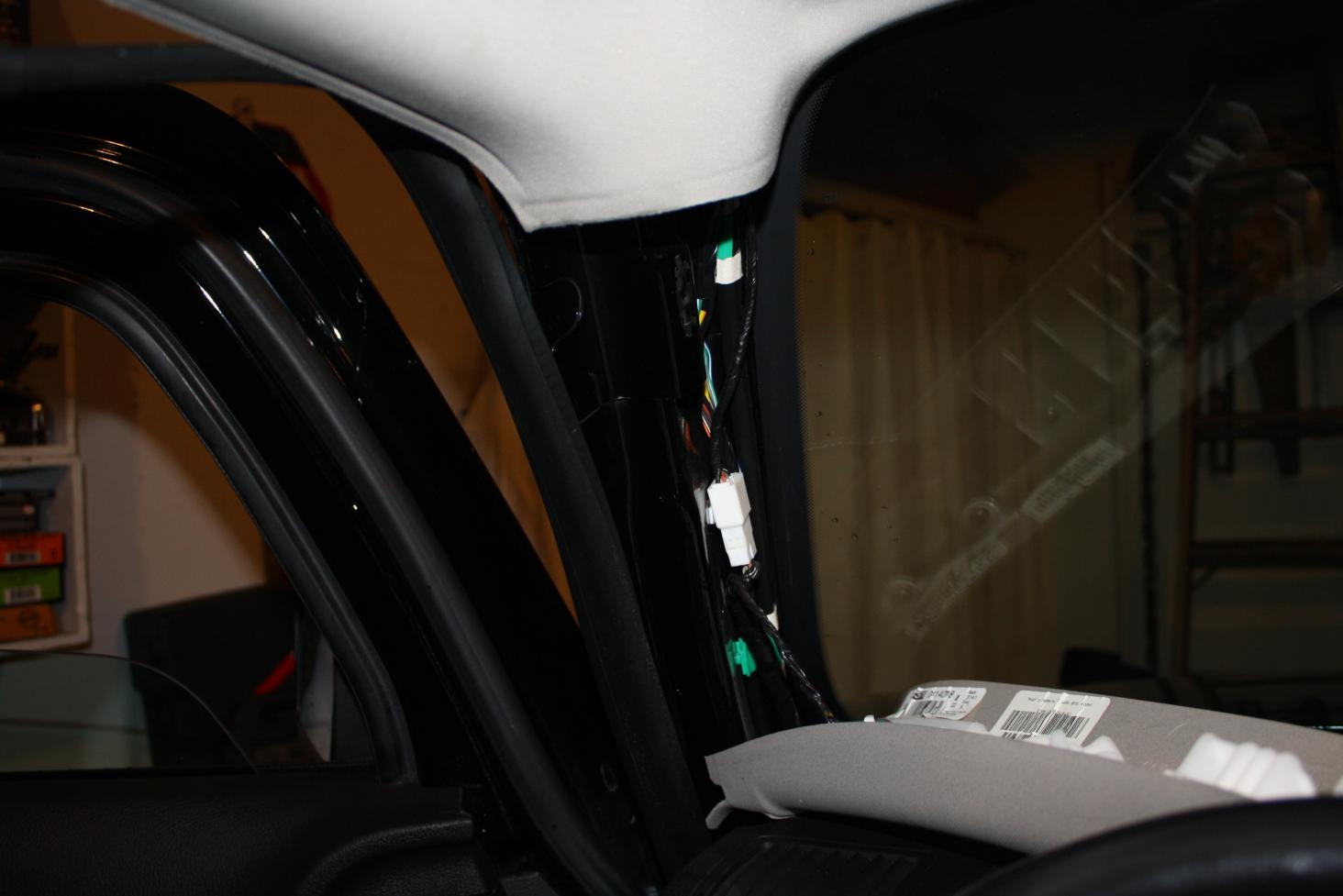

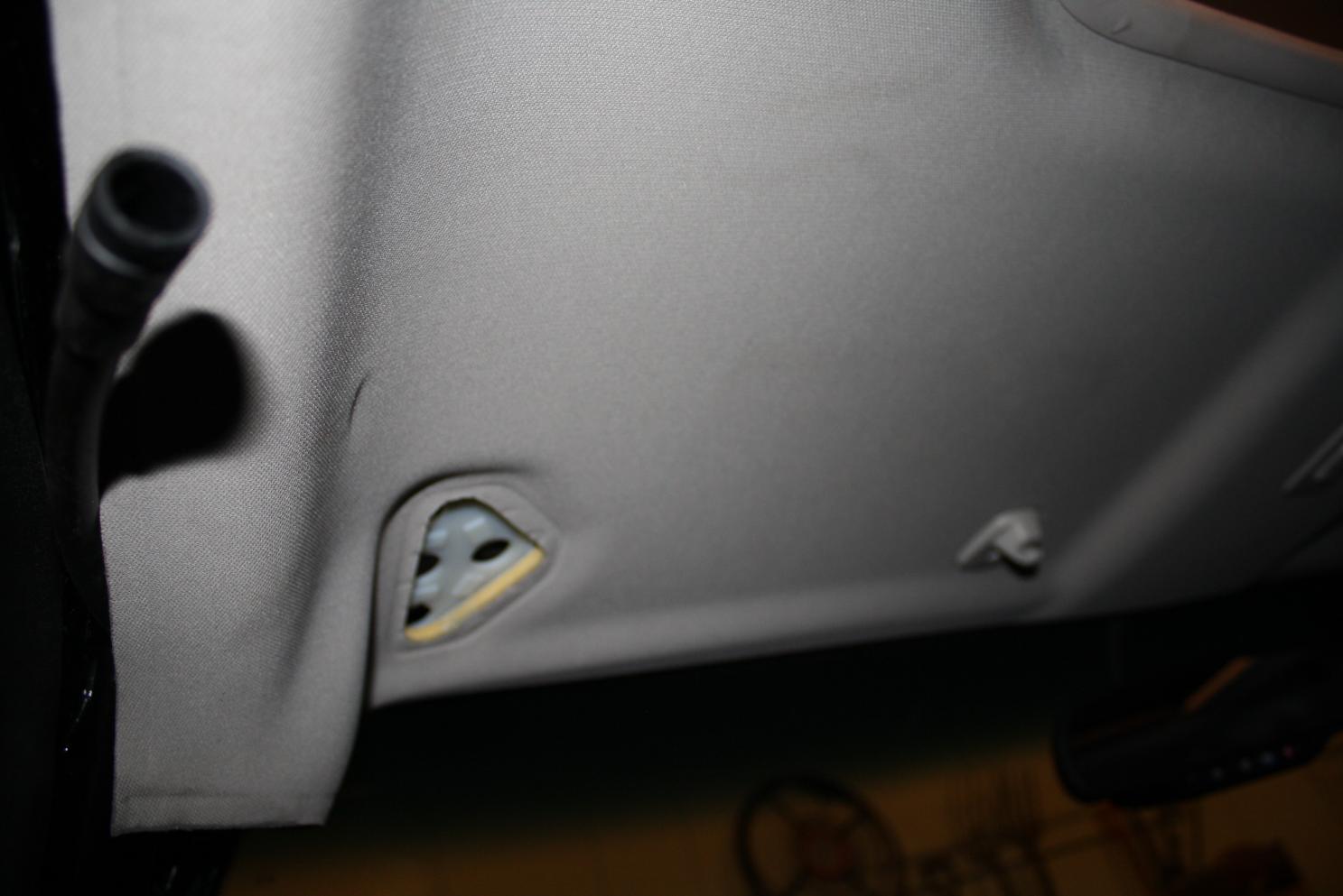

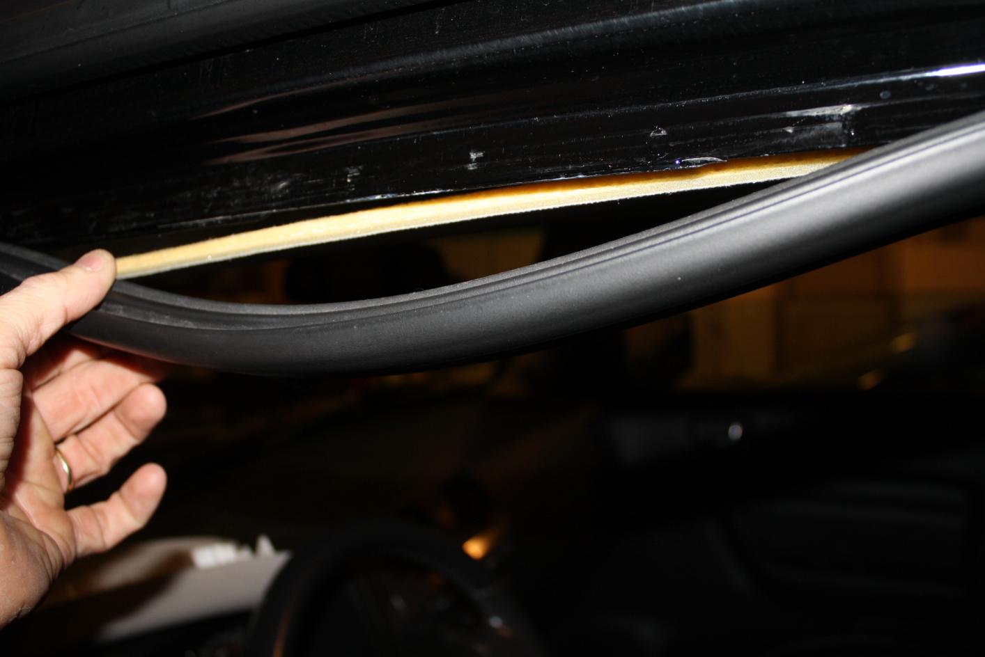

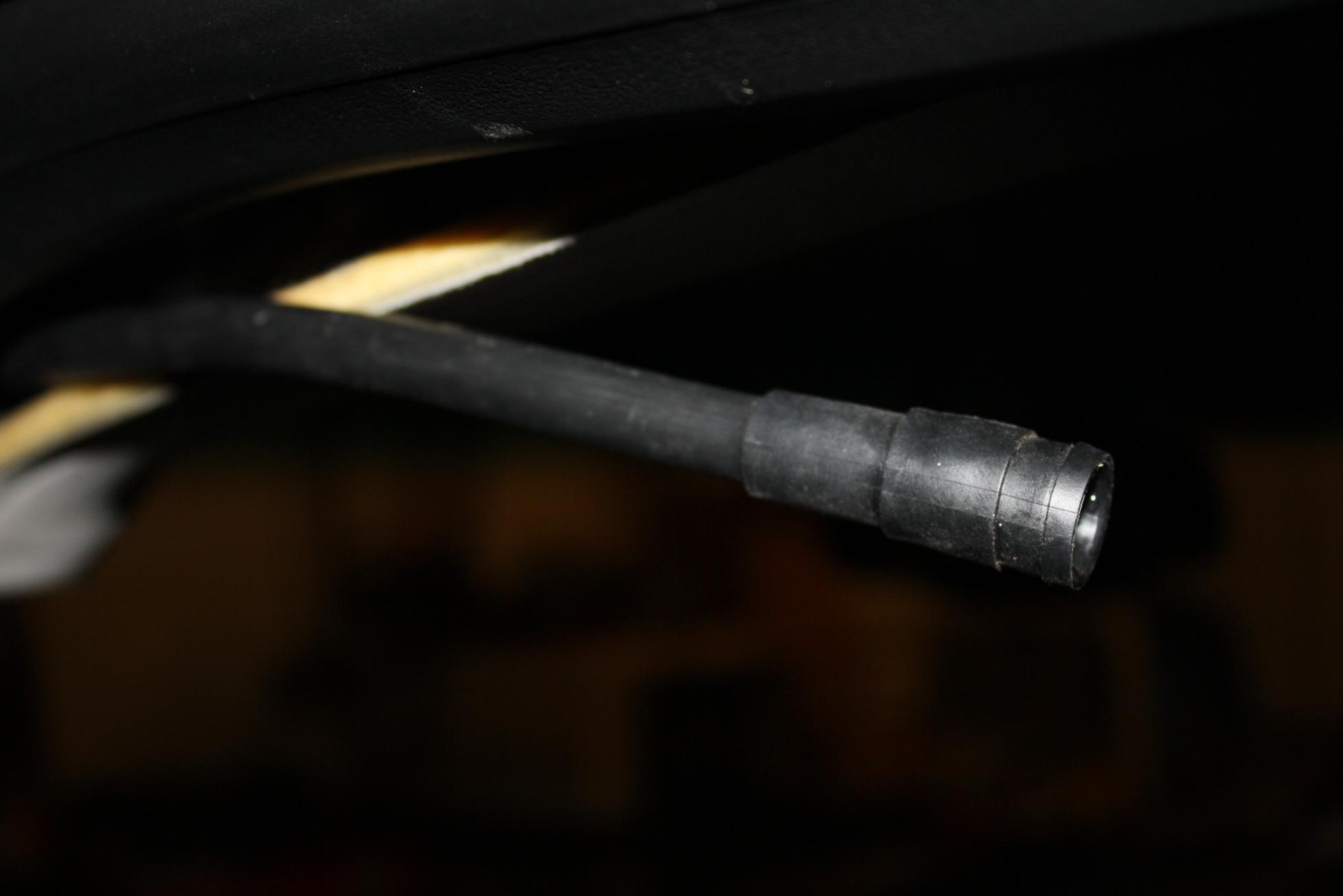

I decided today since it rained today and I got my lap wet from non draining tubes that I was going to fix this thing.
I took pictures because it seemed that this is a common problem.
I took the inner pillar trim (the one with the tweeter) loose, just took the screw out and layed the trim (wires still attached) on the dash.
Took the sun visor completely out. (3 screws)
Pulled the door weather stripping off (PARTIALLY). not all of the way, just enough to pull the headliner down just far enough to reach my hand in to grab the drain tube.
It was plugged with I don't know what, but I pulled it just outside of the door and took a funnel that fit the opening, poured a glass of water into the funnel.
Water poured back out at me. I tipped the funnel back into the glass.
Took an air compressor and blew the tube out. Something was lodged, I heard the air finally blow it out. Repoured the water thru the funnel. Bingo
Re-attached the tube to the drain and re-assembled everything.
Poured a glass of water into the sunroof draining area and the tubed emptied on to the garage floor.
Went to passenger side and did the same thing.
Tomorrow rain is in the forecast. I am confident this thing is gonna drain.
I hope the pics help as I would have loved to of had some to go by.
Just wanted to add, when re-installing the visor there is a white plastic spacer that goes on the inside of the headliner, it is not attached to anything, just lays on top of the headliner but only goes in one way. there are guide holes (slits) that will only attach to the visor one way. So match it up if it falls out which it did on both sides on mine.
