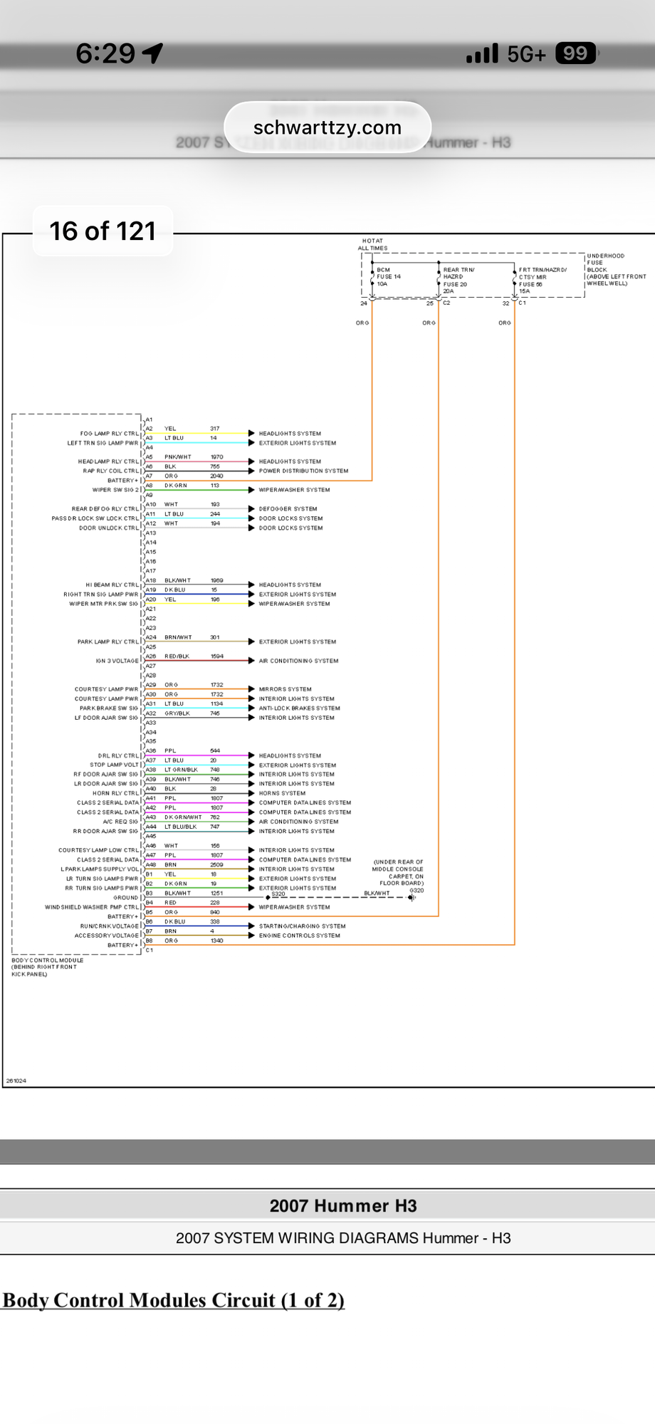

I am redoing my BCM wiring for 2007 hummer h3 because the connector was bad and not connecting well. I am stuck at the purple wires and some orange. where do they end up ? Or where do those wires go to ? so I can check for continuously and put every wire in its correct spot
A41 - A42 and. A47 purple
A29- A30 orange

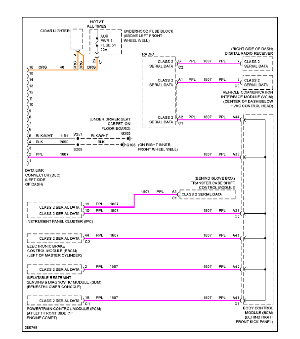

Old Nov 21, 2025 | 01:31 PM
NMH3's Avatar
Joined: Feb 2021
Posts: 270
From: New Mexico
Old Nov 22, 2025 | 07:23 AM
NFS's Avatar
NFS
Joined: May 2016
Posts: 739
Thank you I’ll try to trade those purple ones

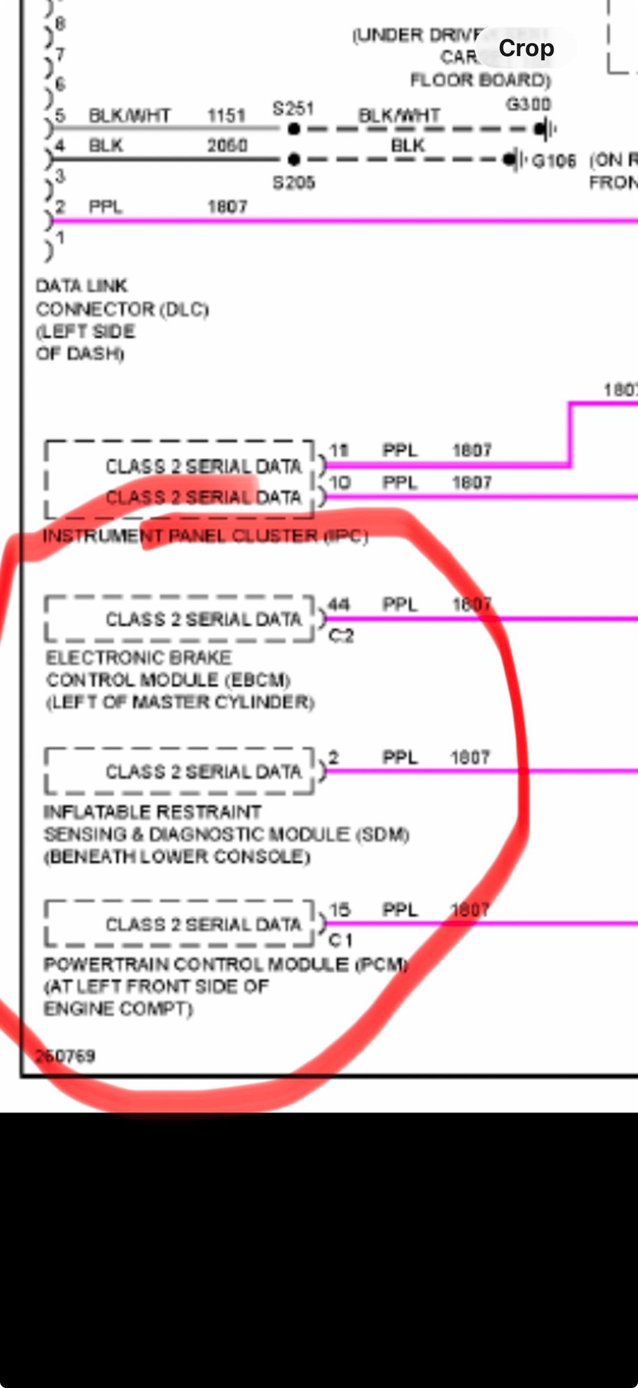

Old Nov 23, 2025 | 02:25 PM
NFS's Avatar
NFS
Joined: May 2016
Posts: 739
I looked everywhere can someone give me details where I can find those and for the pcm which one is it? Black blue or grey ?
