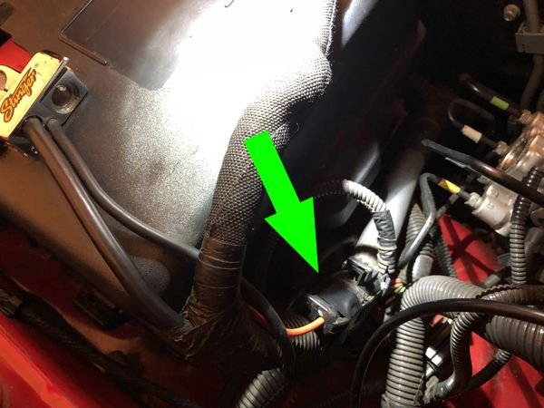

Originally Posted by Car54
First I want to say "sorry" if I'm in the wrong place at the forum. I have an H3 '06, OnStar was the culprit for the battery drain, unsubscribed from OnStar about 3 months ago and it appears that was in fact the parasite. But I want to actually pull the OnStar fuse and I've looked everywhere, here at the forum and online at various sites. I went under the hood of my H3 today and thought I had found the OnStar fuse box but not sure. I'm attaching a photo of where I think it's located but would like someone to tell me if this is the location for sure. We took this standalone apart and found no fuse. If anyone out there knows where the fuse box for OnStar is, we would greatly appreciate it !! Thanks.
OnStar fuse box location? It's coming direct from the battery on a red wire.
