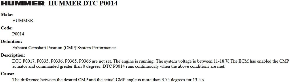

Old Sep 6, 2023 | 01:50 PM
Originally Posted by 4WDIY
Ok. So what would be the fix?
I replaced the VVT/solenoid part a few months ago.
Did you read the bulletin posted above? Bulletin No.: PIP3694F
Old Sep 7, 2023 | 10:17 AM
Yeah, but............ have you inspected the screens on your new CMP for crud?. Review the connection and harness to it. Clean the connector with CRC Electronics cleaner. That is what the code and SB are pointing at.
