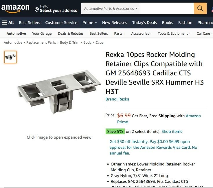

Old May 24, 2021 | 08:00 PM
Old May 24, 2021 | 09:08 PM
Alex DjFlaco's Avatar
Joined: May 2020
Posts: 183

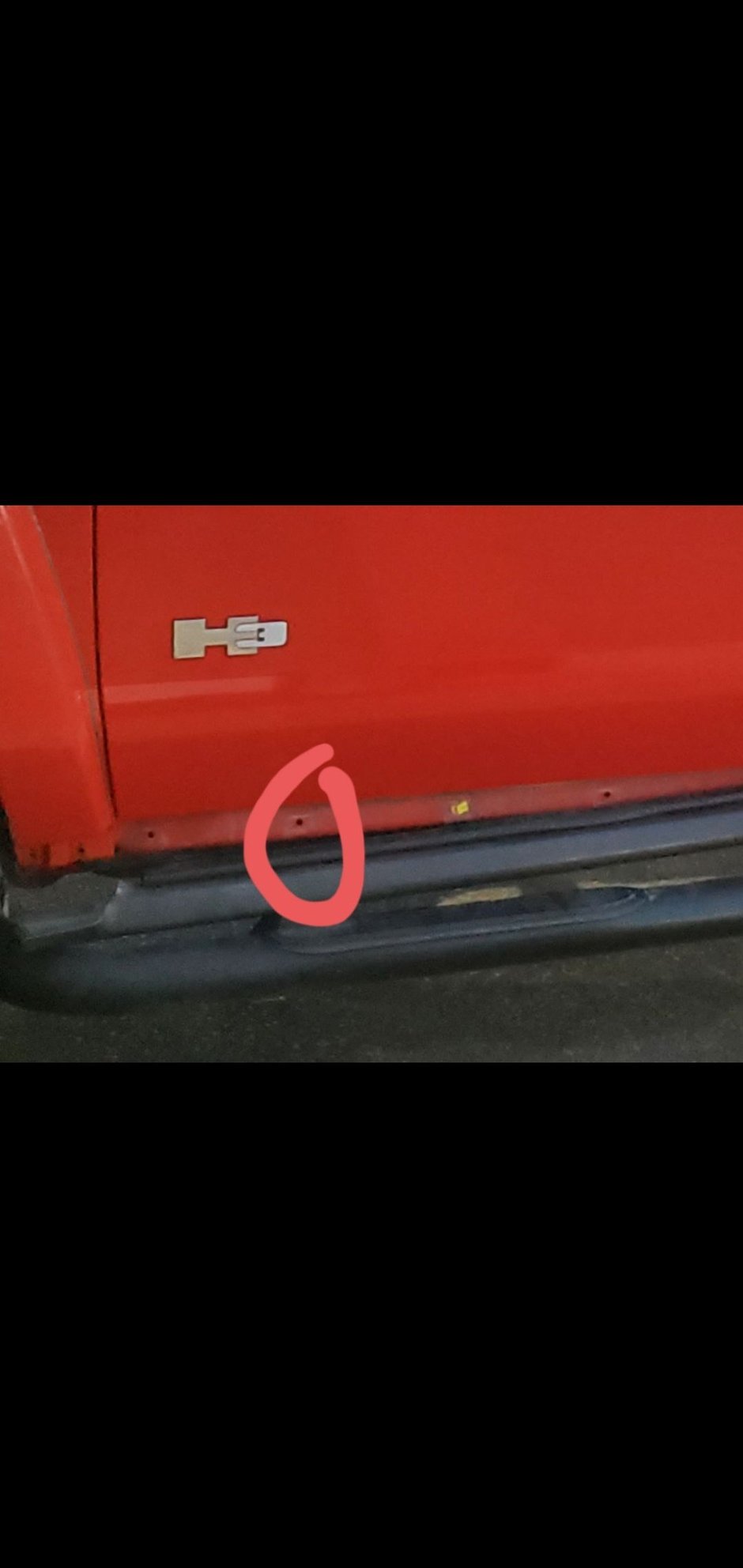

I order that one but it's not the right one. Look at the picture is a circle hole
Old May 25, 2021 | 08:37 AM
I don't see a picture of an old clip? Check these:
Rocker Panel Moulding Clips For Hummer H3 Rocker Panel Moulding Clips For Hummer H3
Top Head Size: 15/32" x 13/16"
Bottom Head Size: 15/32" x 25/32"
Stem Length: 9/16"
Fits Into 3/8" Hole

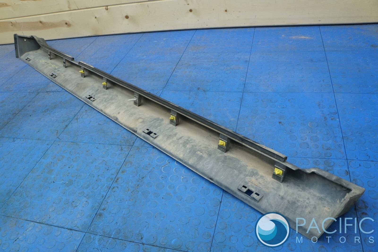

I never removed my skirts, yet now I know what clips are required if I ever have to remove them? The first clip is for lower mount x10(both sides) and 2nd clip is for side mount x16(both sides). Here's a pic I just found on Ebay (15817834):
