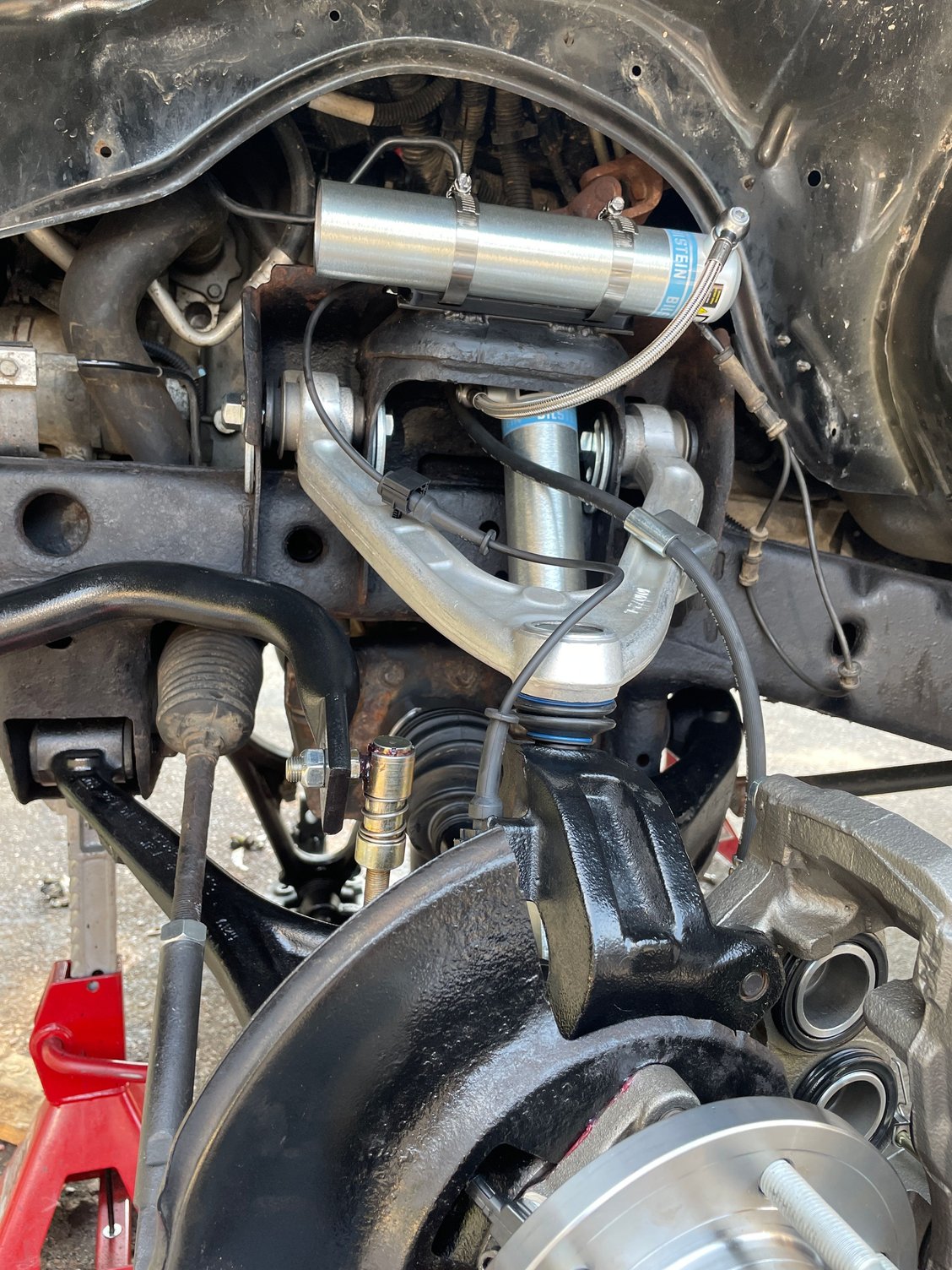

Hey everyone, I’m putting 2007 H3 front suspension on my 08 Canyon. I bought some ACDelco H3 front calipers, but they didn’t come with any mounting bolts. None of the parts stores have them either. Does anyone happen to know the diameter, thread pitch, and length of the caliper mounting bolts so I can run to Ace and get some?

Same bolts threads. I'd be more concerned with that ied strap gear clamped.
1. what???
2. are you sure about the threads? I’m pretty certain it’s the same diameter (M14) but it only wants to go in by hand 1 turn, then it stops. It’s hard to tell but I’m thinking the h3 spindle is tapped for a fine-thread m14. I’m not gonna force it in there till I’m not 100% sure

M14 x 1.5 x 37.5
