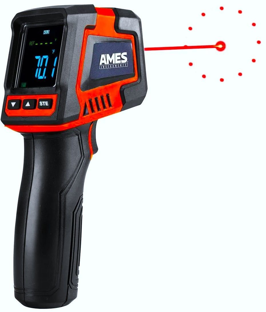

  #58
Posts: 9,014
Did you check the entire coolant system for a huge temperature variance(cold spots/blockage) with an
Infrared Laser Thermometer?
no i dont have that? But how and where to i point that too? Also what this can make a difference?

How long after you replaced the head gasket did you start to notice this bubbling coolant issue? A few hundred miles, or thousands of miles? What was going on that made you notice the bubbling coolant tank issue?
About the IR thermometer, you use it to measure the temperature at different points along the block and at different components in the cooling system looking for abnormal temperatures, which will help reveal if you have excessive hot spots in the system that would indicate a blockage or some other type of issue causing high temperatures.
