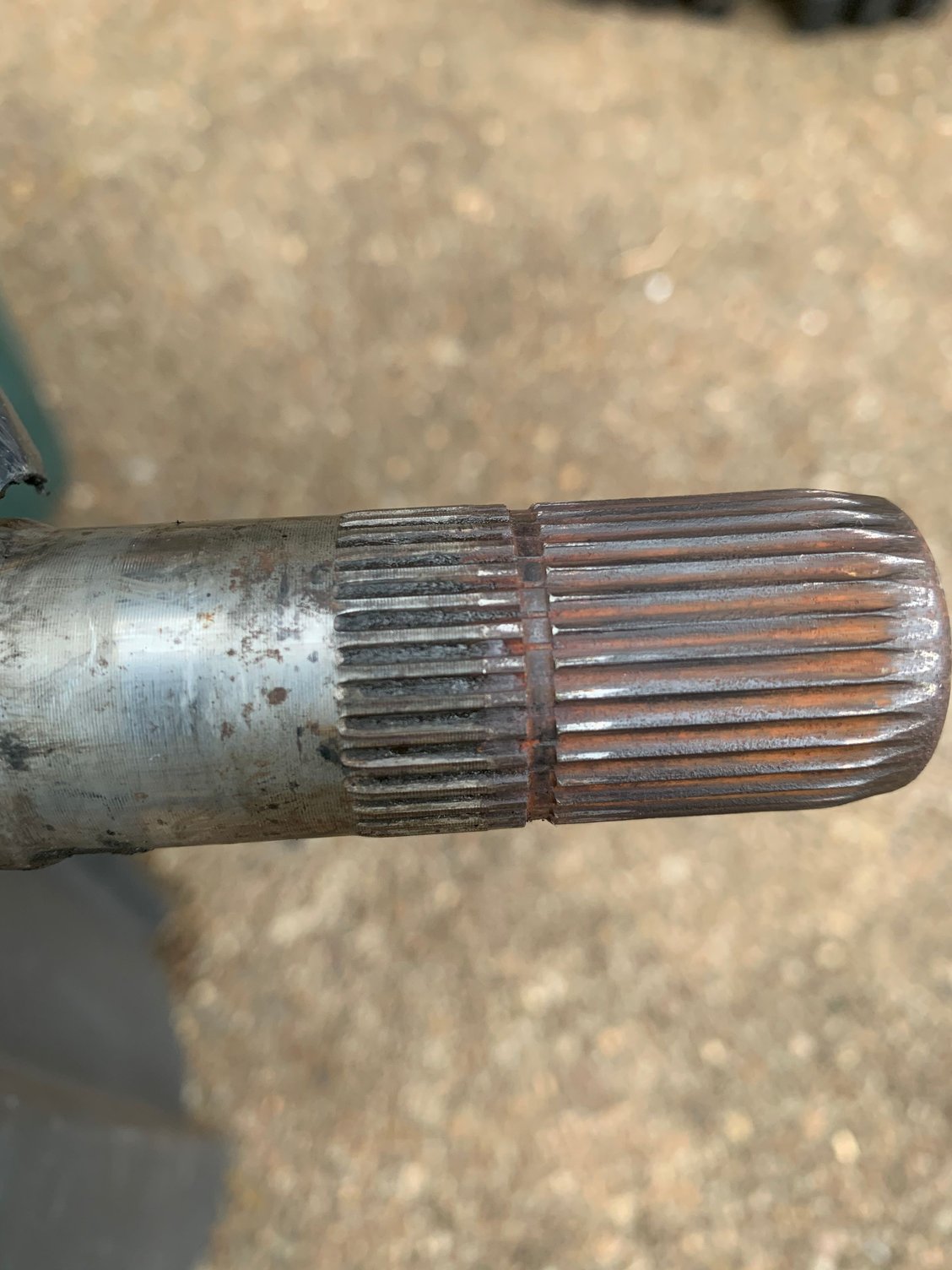

front driveshaft CV is worn out. I got the shaft out and finally got the cv joint off and the driveshaft splines are worn.
Apparently OEM shafts are on BO nationwide and I have heard terrible reviews on the cheap ones.
I might take it to a machine shop and see if they can repair the splines on the original.

Oh, I was waiting on an update for the fluid intrusion. Post a picture of your driveshaft splines, may just need a touch up with a file.

The splines are pointed below the groove and more flat above the groove where they have no wear

Looks good to me. Grease it up and install new cv joint.
