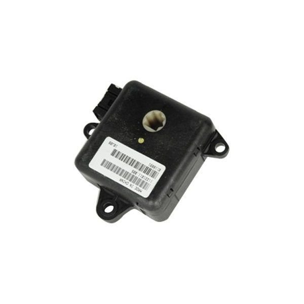

Dorman 604-188 HVAC Blend Door Actuator Compatible with Select Hummer / Pontiac / Saturn Models
ACDelco GM Original Equipment 15-73200 Temperature Mode Valve Actuator Assembly

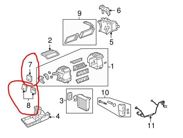

Old Apr 8, 2022 | 10:22 PM
Posts: 9,014

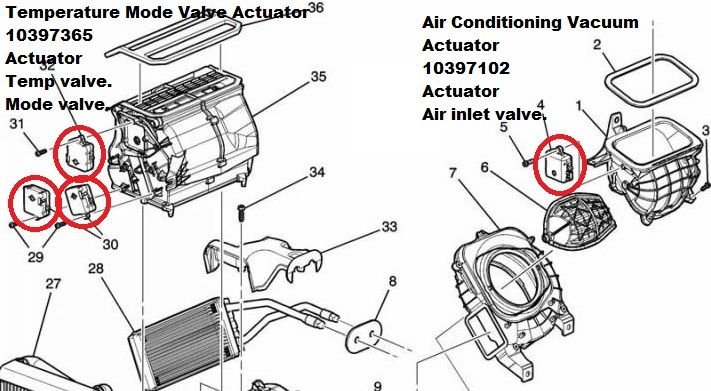

>>>>4 actuators!
Old Apr 9, 2022 | 08:44 AM
As you can see there are 3 on one side
#7 & #8 are different.

I'm gonna crawl under there and look for that 4th one. I spose it works in conjunction with the AC selector. I spose it moves simultaneously as when the other two on the drivers side move.

4th 1 is air-recirculation. The question is why you have 3 dead actuators? My '07 all 4 assembly line installed back in '06 and still working perfectly.
Did you test them for operation dismounted? Any signs of rodent intrusion under the dash? Having 3 dead makes 1 wonder if there's an obstruction inside the case?
