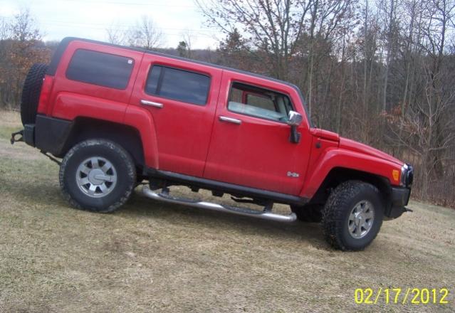

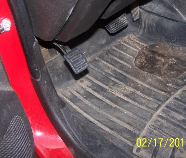

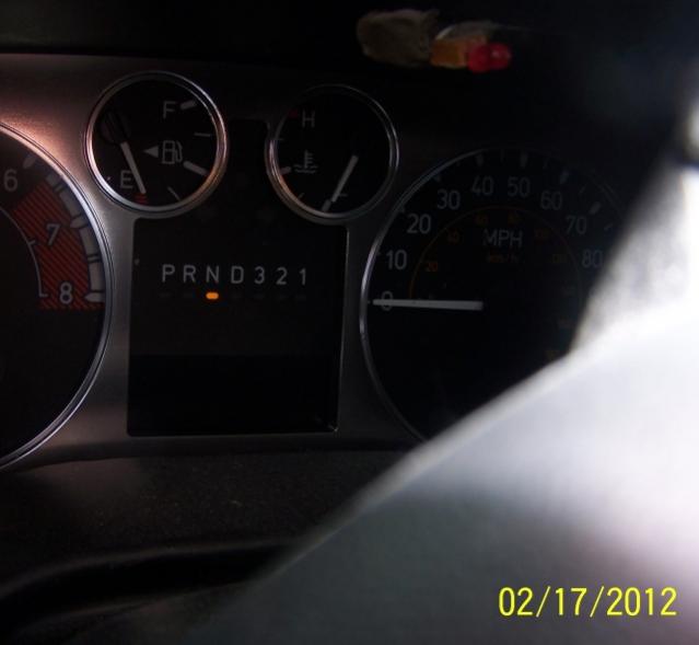

last week in snow i slid down this hill doing the same test.
this is lock mode,neutral,key off just "stuck" there in bind up mode.
when i shifted to 4 hi it still stuck till i hit rev,then neut so it did not release the lock mode
till unloaded. probably not a good idea to shift when stuck,cant move to open mode
just the facts,,no theory!!
