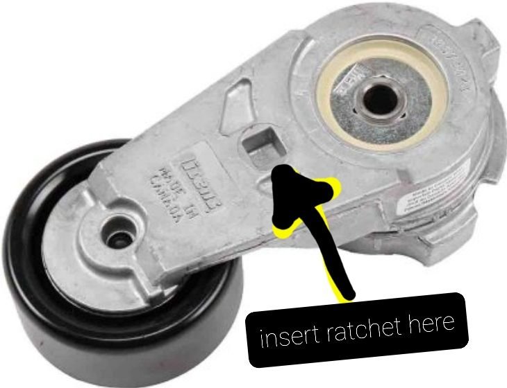

Hey Mike, I just use a 3/8" drive ratchet and the loop end of an adjustable wrench over over ratchet handle if I need more leverage. The 3/8" "head" or "square" should slide into the little box cutout on the belt tensioner arm. By applying force to the ratchet, the tensioner compresses, ultimately loosening the belt and allowing for belt removal. Here's a video on tensioner replacement. It doesn't show what I'm talking about in detail but may be of some help. An actual tensioner tool is pretty unnecessary.

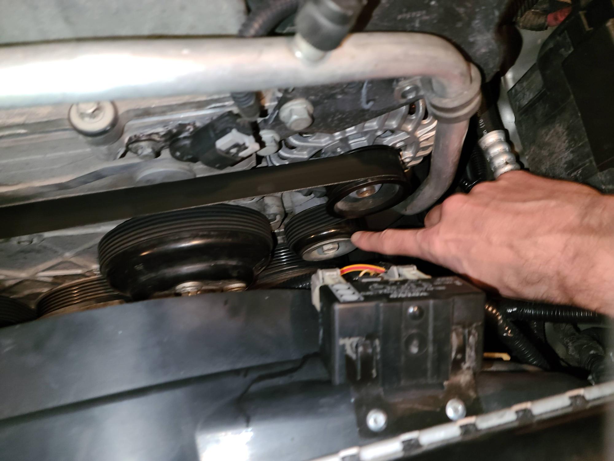

Hey Mike, glad to you figured out! The layout is a bit challenging to maneuver around, for sure. Here's a photo of the method I use to avoid removing the hose (I do not like dealing with those spring loaded clips) and air box. It should only take a few minutes to remove and re-install a belt using this method:
Standard length 3/8" drive handle & large adjustable wrench.
Ratchet into tensioner arm cut-out & handle loop of adjustable wrench around the handle of the ratchet for leverage. This is still doable with the mechanical fan, although the fan is "touched" by the wrench. This step avoids having to remove anything else.
I slip the belt over this pulley last during re-installation because it seems easiest to me.
