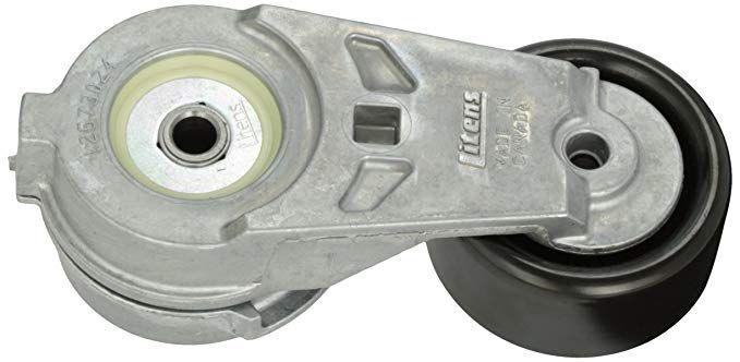

I am enjoying the smells and sounds of a slipping serpentine belt in the 2007 H3. Bought a new belt in Autozone and then ran into the problem of removing the pressure from the tensioner pulley to remove the old belt. As far as I can see, the center of the pulley has a round, not square hole. What gizmo is needed to move the pulley down?

This is the tool...
https://www.harborfreight.com/serpentine-belt-tool-kit-63689.html?cid=paid_google_pla_main_newproductsgen eral_63689&gclid=Cj0KCQiAurjgBRCqARIsAD09sg-xHFqinGgw0EN1GFFKDwbPN3Dgp4wr5oDgluuo49ikk42mucaxj yAaAsBLEALw_wcB
HF has em. There referenced as Serpentine belt tensioner tool.

Id replace the tensioner too, good maintenance and if your belt is noisy now, may have a weak spring in it.
Old Dec 11, 2018 | 10:52 AM
Any long 1/2" breaker bar will work, the square hex is not in the center of the Tensioner Pully, it is in the body arm of the Tensioner itself.

Went to AutoZone to buy the tensioner roller assembly and take advantage of their generous tool loaner plan. Everything went well until I got to the refitting the belt. With the long bar there wasn’t enough room to get sufficient pull. The small bar which works with the long one has a 1/2 inch nub and the hole is 3/8 inch. Went back in, bought an adapter and two minutes later was running the engine.
