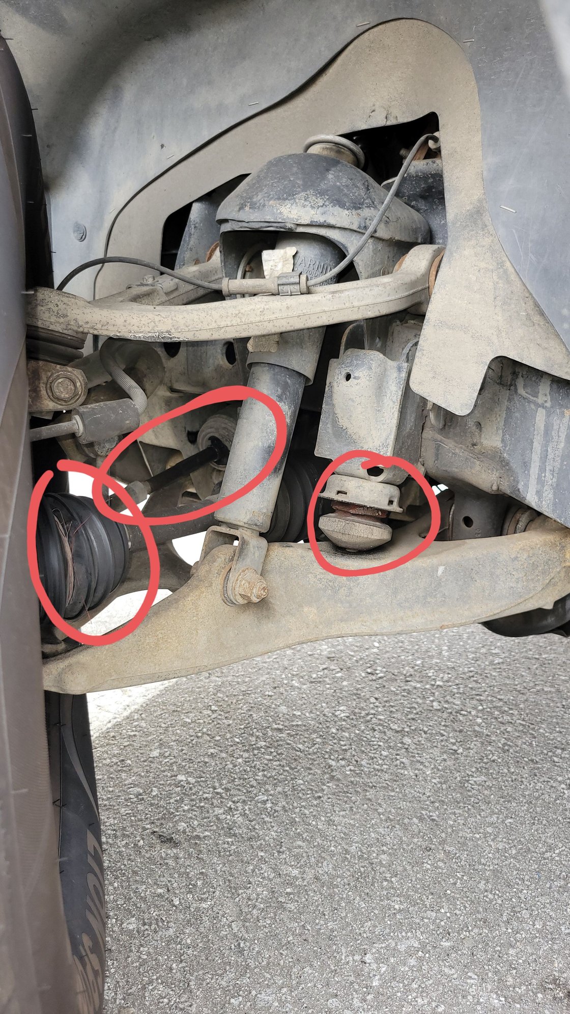

Default I need my car fixed
are you sure you want to tackle that? if you do not know what they are called? not being a ***** just worried.
I don't know anything about car parts. I noticed my car was making a weird sound near the wheel and checked. I noticed that their was a part with a wire popping out, a broken part, and a part with a leak. I want to to buy the parts so I can fix my suv. This is my fist car and in a hurry to fix it before I go to school.
Old Aug 4, 2021 | 04:51 PM
Posts: 3,204
the part near the wheel that is rubber with the wire wound around it is the cv boot. it the wire has not cut the rubber then just remove the wire it does not belong there. the next rod that goes to the wheel is the tie rod the part that looks pushed in is rubber and should move like an accordion as you turn the steering. if it is not torn then it might be fine. the vertical pointy rubber partthat is sitting on the lower control arm is the bump jounce. it helps with suspension.
