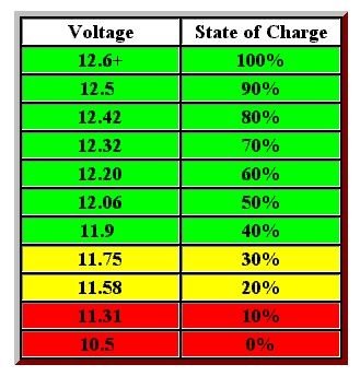

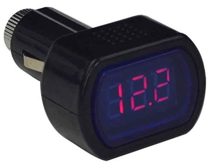

2 weeks, not a parasitic draw! I recommend to monitor battery voltage! This past year was mostly 1-2 mile trips, shut off, restart, drive home. I never gave the alternator enough time to recharge the battery. I give the battery some attention when I see 12.2v with an all day 2amp charge.
Here's a cheap(less than $5) voltage tester without opening the hood + battery voltage chart:
