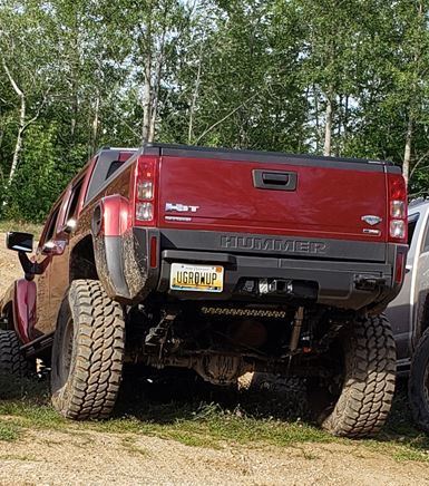

Doc, I picked these up on clearance at Menards for $18/pair. They mounted real nice without any modifications to the safety chain slots on either side of the hitch receiver. I used thumb ***** for mounting and quick disconnect harnesses so if I needed to use safety chains it was an easy R&R. I wired them in to the trailer wire harness reverse wire, but also added a switch and a separate wire to turn them on independent of reverse. I put a diode in each of the lines to prevent current back-feed. They're bright as hell! Got these several months ago so I'm sure they're gone, but you can pick up the same 4" x 4" led spots or fogs just about anywhere. Good luck.
BTW....they don't hang lower then the hitch receiver so they're protected when wheeling.

Old Jun 11, 2020 | 01:29 PM
That looks good, but the on and off when I tow stuff might be a pain???? Now that the youngest is done with collage, the towing stuff will be way down. Thanks for the pics.

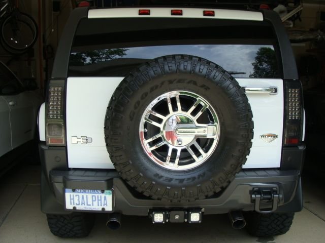

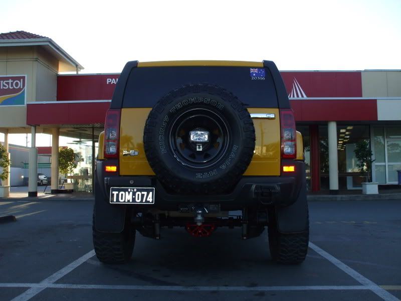

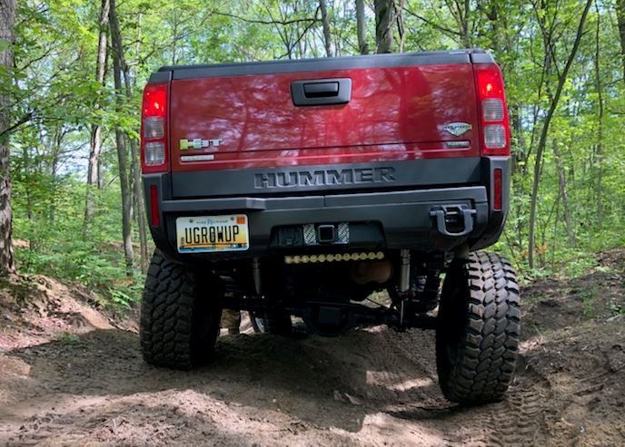

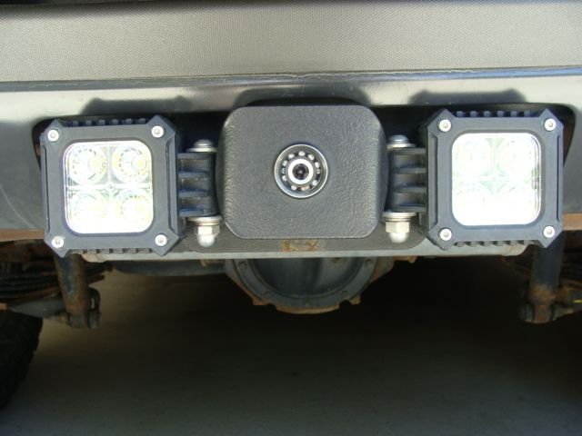

Old Jun 12, 2020 | 06:37 AM
DOC,
Skippys rig:
Spare tire light, you could use 2 - 4" cubes pointed left and right?
I wanted to replicate the red euro "fog" lights on this one and use floods for the H3. Then we went to 2 "Ts".
My "T". unless you are going to do a muffler delete this probably won't work for you
What diode did you use? I used the same trailer harness for my "T" lights and I get a "fuzzy" reverse camera signal when they are on.
Please advise.
Please advise.
This one:
Amazon Amazon
If you're out Rochester Hills way send me a PM. I've got a bag of them and I'll give you a few.
Old Jun 12, 2020 | 09:58 AM
Thanks you guys! Good stuff. I could not remember where I saw the spare center light, but now I do..... bringing back the old memory Taint.
Keep the ideas flowing if there are more out there.
