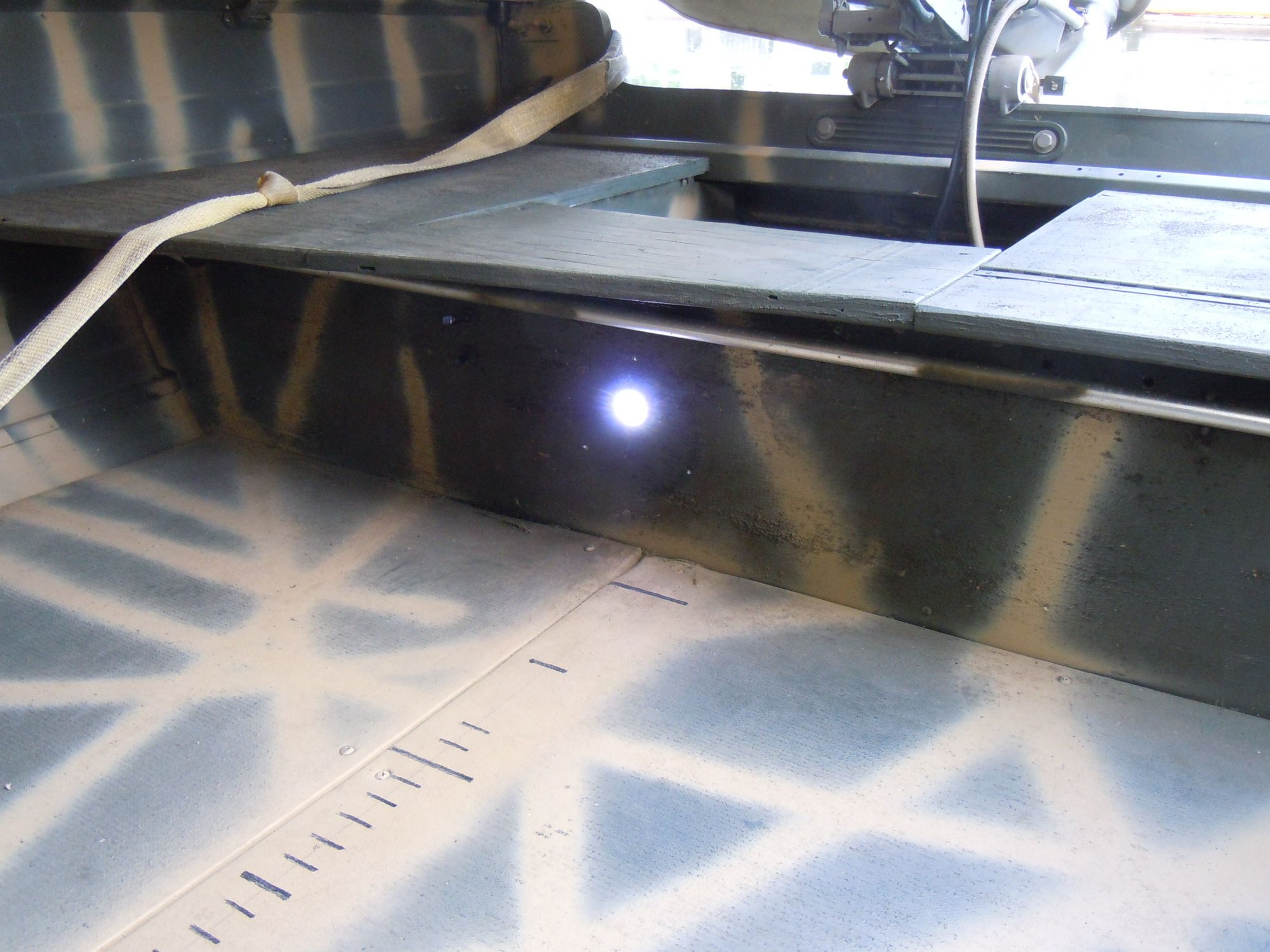

Old Jul 16, 2020 | 02:26 PM

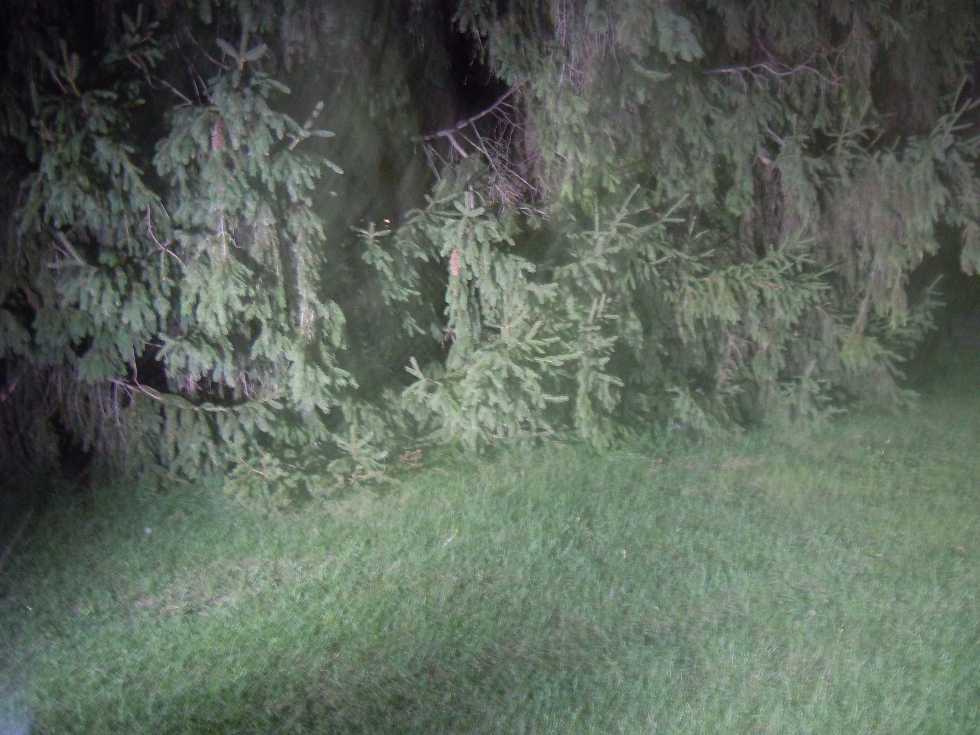

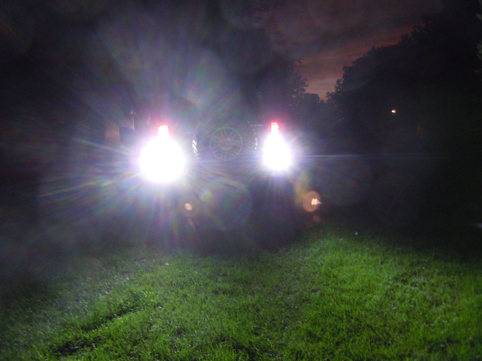

Old Sep 3, 2020 | 09:16 AM
  #30
Posts: 13,105
Originally Posted by TAINTER
They look good Doc, can we get a few night time photos? Even a dusk photo would work since your old and probably can't stay up late enough for night shots...
Finally stayed up passed sunset! Went over to our vacant lot across the street to see what I could see.
When I back into the drive, EVERYTHING is lit up!
I was standing in front of these pine trees about 35 feet away from the truck when I pointed the Nikon at the lights.
