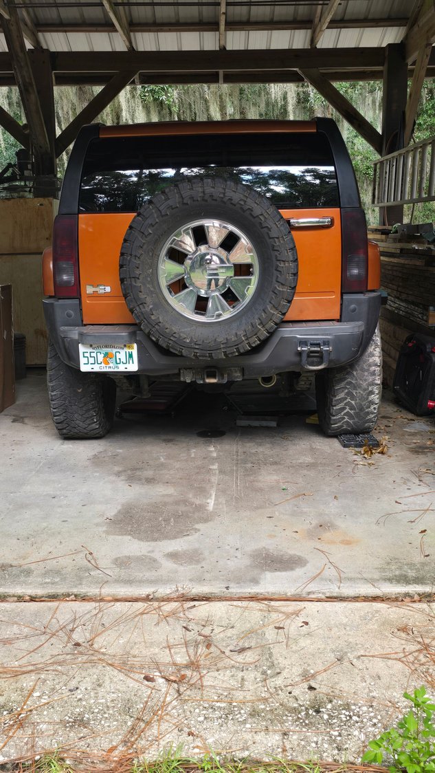

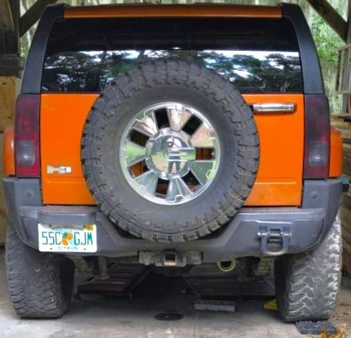

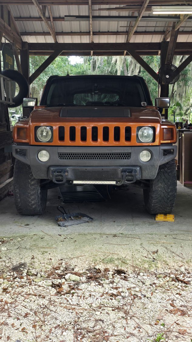

What are the current measurements both sides front & rear? My leafs are still OEM factory installed and I abused the living sh>t out of them carrying overweight loads numerous times! I just checked my '07 and both rears are @24.5" empty.
From the ground (concrete slab) drivers is 39 7/8 passenger is 40 5/8.
Front looks pretty level
Rear leans to the drivers side
Your tires tread appear worn uneven along with the ground. MEASURE FROM CENTER WHEEL TO FENDER LIP!
I will, and report back. Just a noten i have more tread on the low side than on the high side.
Your pictures also show unlevel ground below. Measure the right way as posted above and post the results on all 4 corners.
