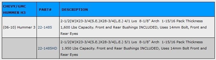

I see Dorman makes them but not a fan of there products to begin with. There are several other companies that make and sell them, even found a heavy duty version 1920lbs vs stock 1560lbs capacity. I know OME make good stuff but there's adds 3/4 inch lift. I believe I already have longer shackles so I don't need that. I have order springs from RC before and they didn't last 6 months before they started to sag. They did warranty it but still, I had to do double the work.
Dorman (Since 1918)
Corporate Office3400 E. Walnut Street
Colmar, PA 18915
{{{{LIFETIME WARRANTY}}}}
1600lbs OE 4/1 leafs(15278386; 25965051) vs 1950lbs AM 5/1 leafs(my a$$$ hurts just thinking about installing an extra leaf)
Dorman 22-1485 Rear Leaf Spring Compatible with Select Hummer Models Dorman 22-1485 Rear Leaf Spring Compatible with Select Hummer Models
