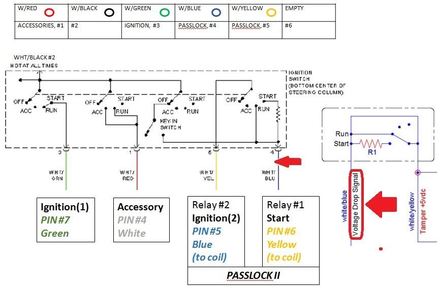

Not those crappy azzed terminals?
Switch can be replaced to correct, however crc electronic contact cleaner works too!
That damn white wire with a blue tracer will cause an issue when there is a low voltage drop signal!
Just clean the connections to correct!
Many have cut the wire and drive with the warning light on the dash.
