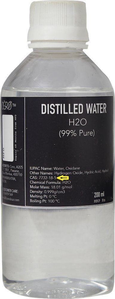

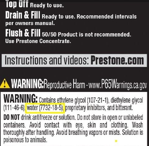

I always use distilled water if I do the mix myself, but the pre-mixed 50/50 is a no brainer.
Distillation effectively removes inorganic compounds such as metals (lead), nitrate, and other nuisance particles such as iron and hardness from a contaminated water supply. The boiling process also kills microorganisms such as bacteria and some viruses.
AKA: 7732-18-5
AKA: 7732-18-5
Correct.... I use distilled because tap water (city water systems) use chlorine and fluoride, and some is hard with calcium and other minerals you do not want in your coolant.
