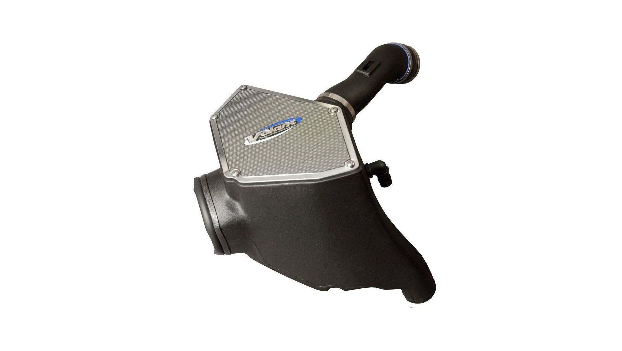

I just did a search on your question and found a nice clean/airtight install here on HF.
Except, as I said before, that round part at the bottom of the Volant box above is OPEN..... their attempt to get more air spoils the effort by adding in warm air in from the bottom. It does look cool though.
Yes, that defeats the purpose of CAI, it needs a scoop air intake routed outside the engine compartment, like this:

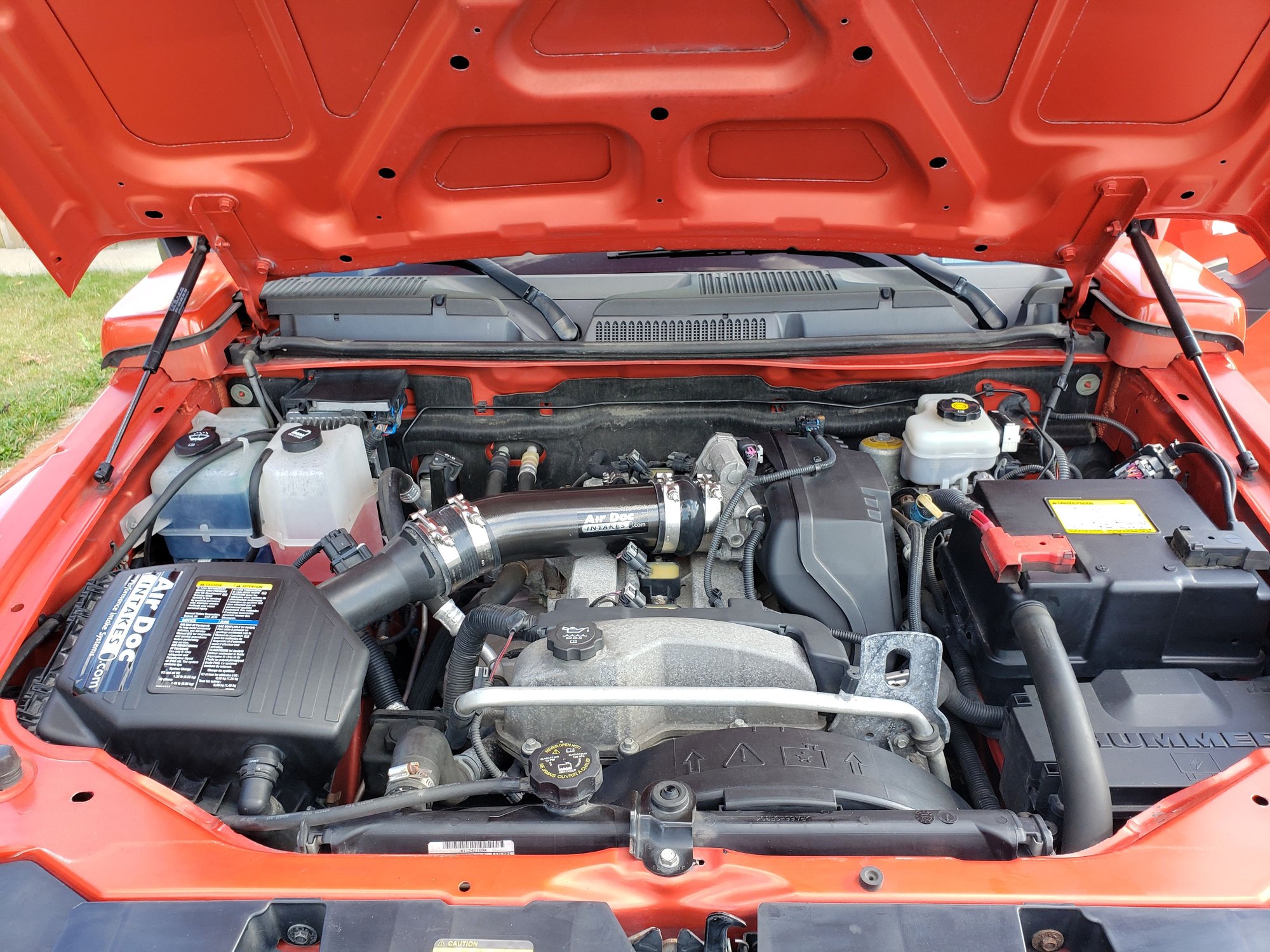

Wow this blew up in the two days I did not check it
I went ahead and got the air doc intake and hooked it up really easy really clean great product.
If I would have known that airdoc was so local I would have just picked it up and saved him the trouble of shipping it.
But noticeable Improvement and quality of life in this vehicle even at a hundred fifty thousand miles

I don't see where you gained performance? You still have 3'' inlet restriction from the air box, removed the resonator, and it appears you used a steel air pipe, which will absorb heat rather easily, and increase the temperature of the air flowing into the throttle body.
