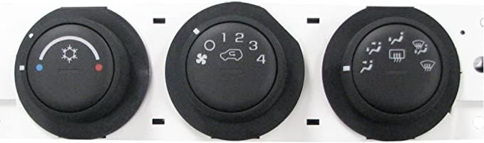

Make sure the dials are set properly. Max cold, airflow to straight vent only, Start up, turn fan speed to 1, press recirc button(on the fan speed dial) press button (on the h/c dial). Wait approx 5minutes....you should get a min, 40° drop from ambient @85°+
So not put it on max fan speed ? Just on 1?
