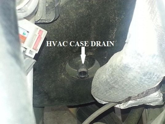

24oz is the proper amount. AGAIN, WHAT IS THE TEMP AT THE CENTER VENT? A/C ON RECIRC ON FAN SPEED 1, CLOSE ALL OTHER VENTS AND INSERT THERMOMETER IN CENTER VENT. ALSO, CLEAN OUT DRAIN TUBE TO HVAC CASE.(LOWER FIREWALL PASSENGER SIDE)

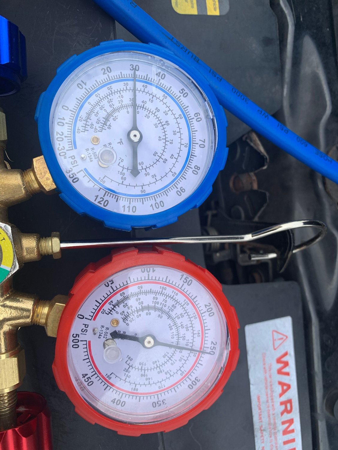

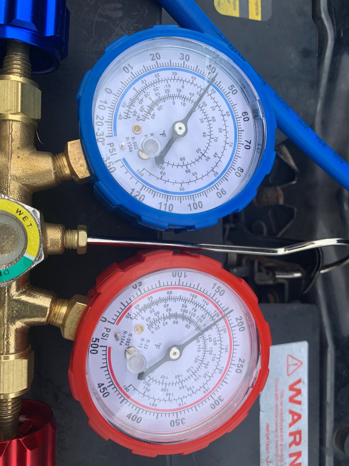

I sprayed inside it it dipped few times then it start to drop water drops when ac is on so it’s not glocked . I can hear the compressor kick in and off now that it’s only 90 degrees
this when compressor stop
this when compressor running. Is that normal. It shows on the low side 30 but the ac is cold now

the gauges you have have a temperature ring the second ring. when the system is off and truck not running the high side and low side should equalize after sitting. look at the temperature ring on both when it does equalize. both gauges should read the same pressure at the given ambient temperature. so for correlation at 90* F it should have a pressure of about 104 - 105 psi hard to tell from the angel of the picture when properly charged. if the readings are too low or too high it will not match the outside air temp. both high and low need to match pressures. this is what is called a static pressure test. it is a quick diagnostic test to see if you are over or under on refrigerant. when you have the proper gauge set. not all gauge sets have the ambient temp reading on the dial

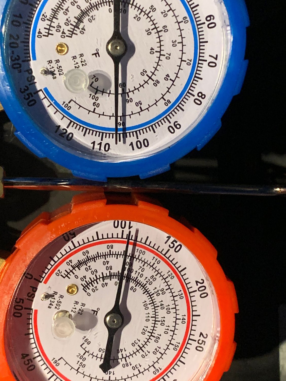

Keep gauges connected, shut off engine and watch the gauges equalize(time how long it takes). Post your results, along with current ambient temp.
temperature is 96
took 5 mins for the needles to stop on both gauges
that’s the result in the pic
numbers are solid. So does that mean it’s charged? Or what should I do next?
