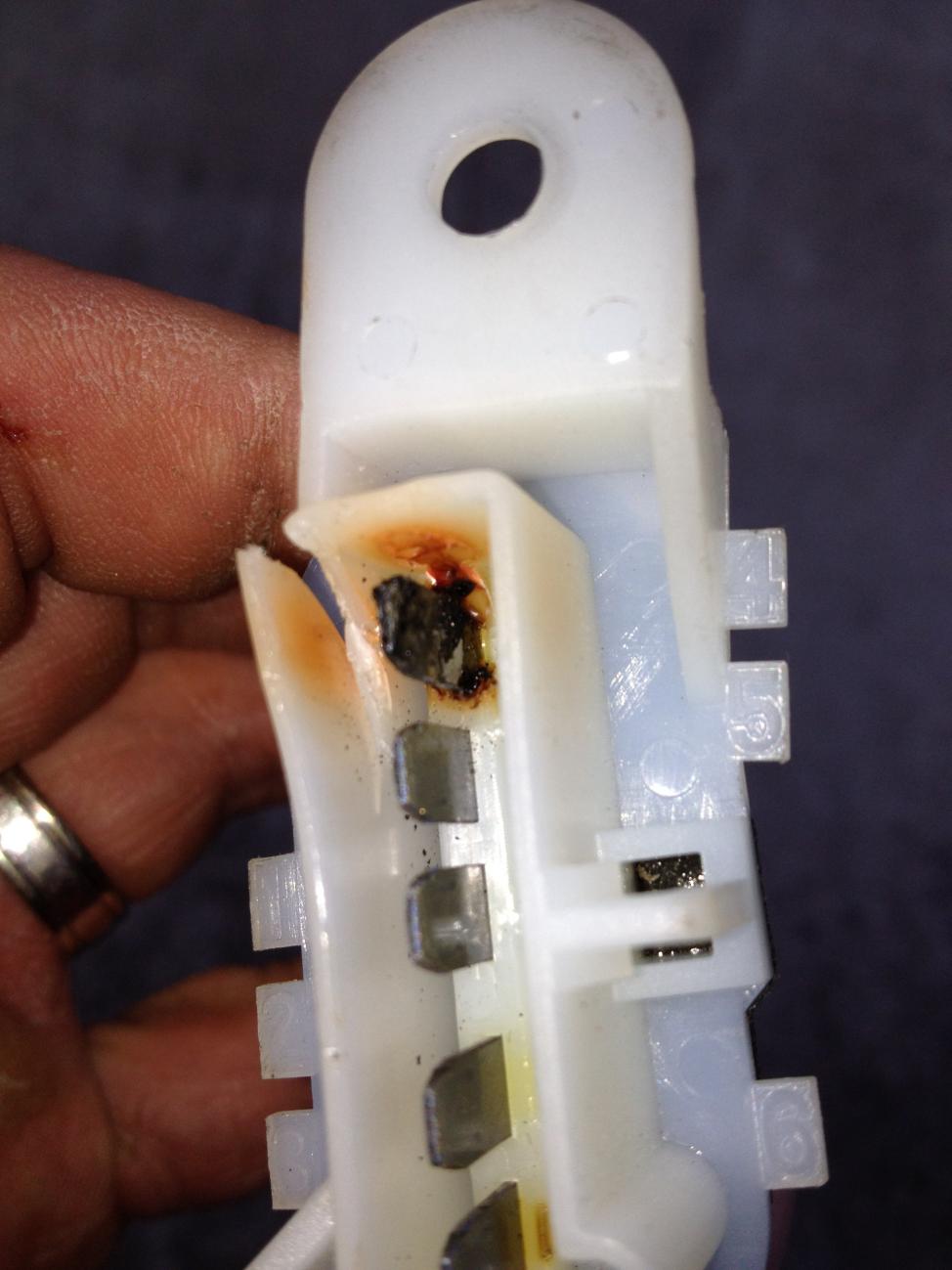

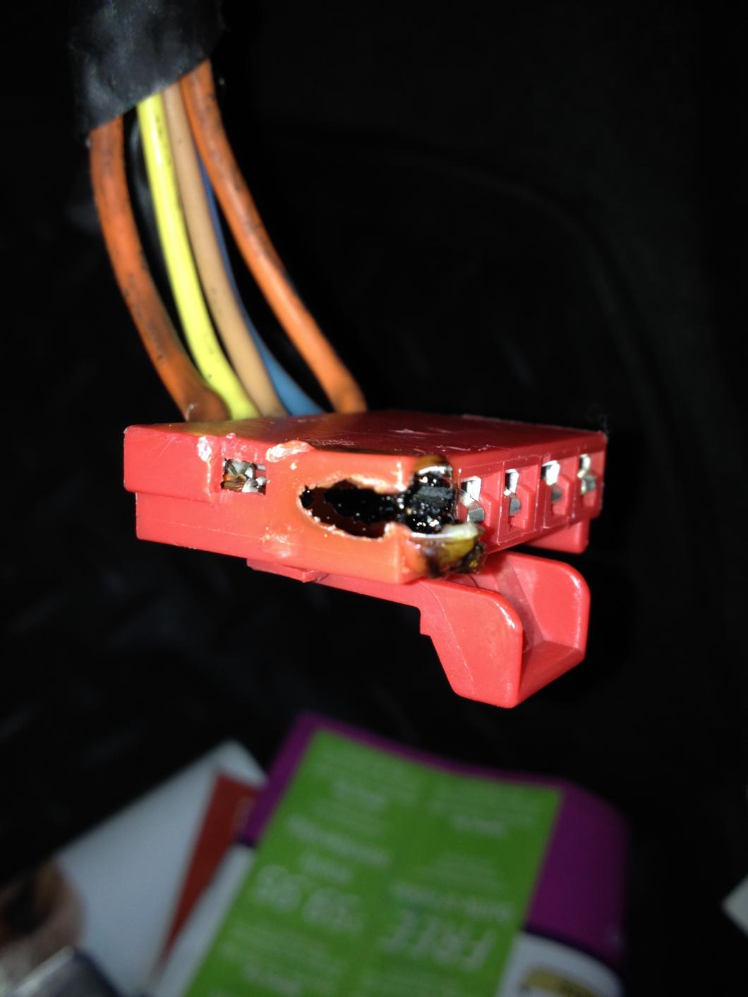

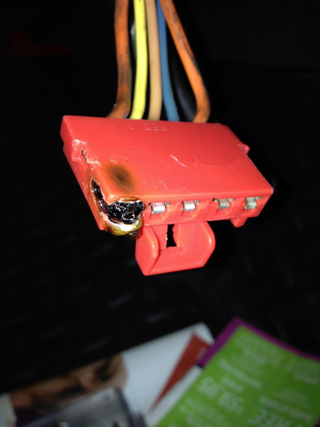

Thanks for all the great post! I just got my 06 Hummer 3 weeks ago and now i have the same problem. There are 3 good vids on youtube showing how to replace the harness.I will be contacting WSMV channel 4 here in nashville to see if they might do an investigative story on this problem.They have done several stories on GM problems.I will be contacting my congressman and senator to let them know since there investigating GM as well.Maybe if enough of us do this will get some results.
Last I checked, the GM that built your vehicle went through bankruptcy and lack of AC is not a safety concern. Good luck with your plan.
