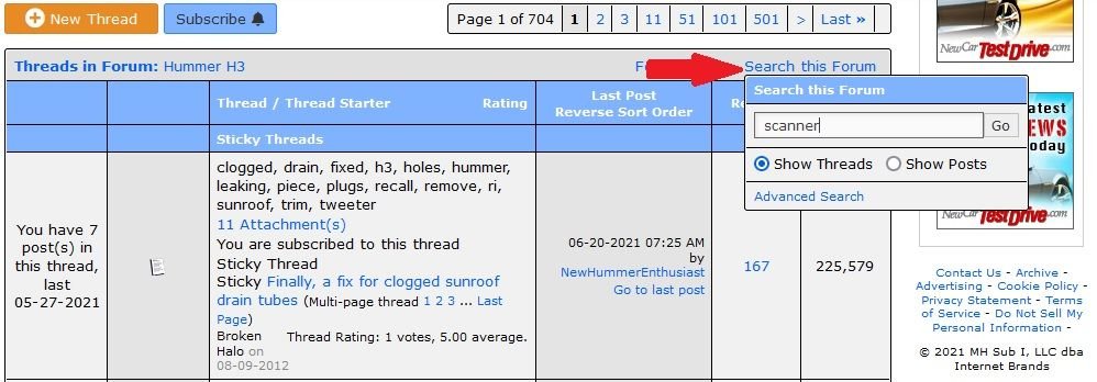

Use the search feature and you will find many threads discussing this same topic:
Service Stab - Best Code Reader?
