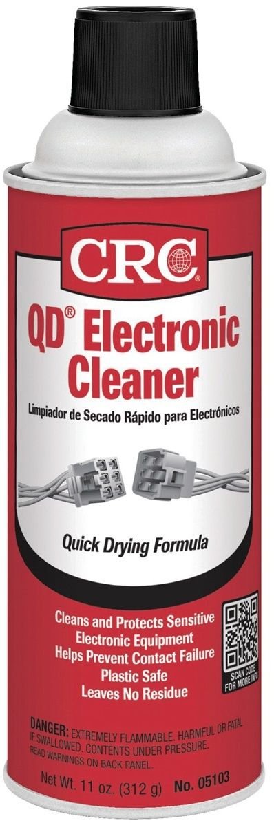

Sensor only needs calibrated when installed in the improper position. Connector can't be loose unless tampered/damaged. Contact failure could be the source?
