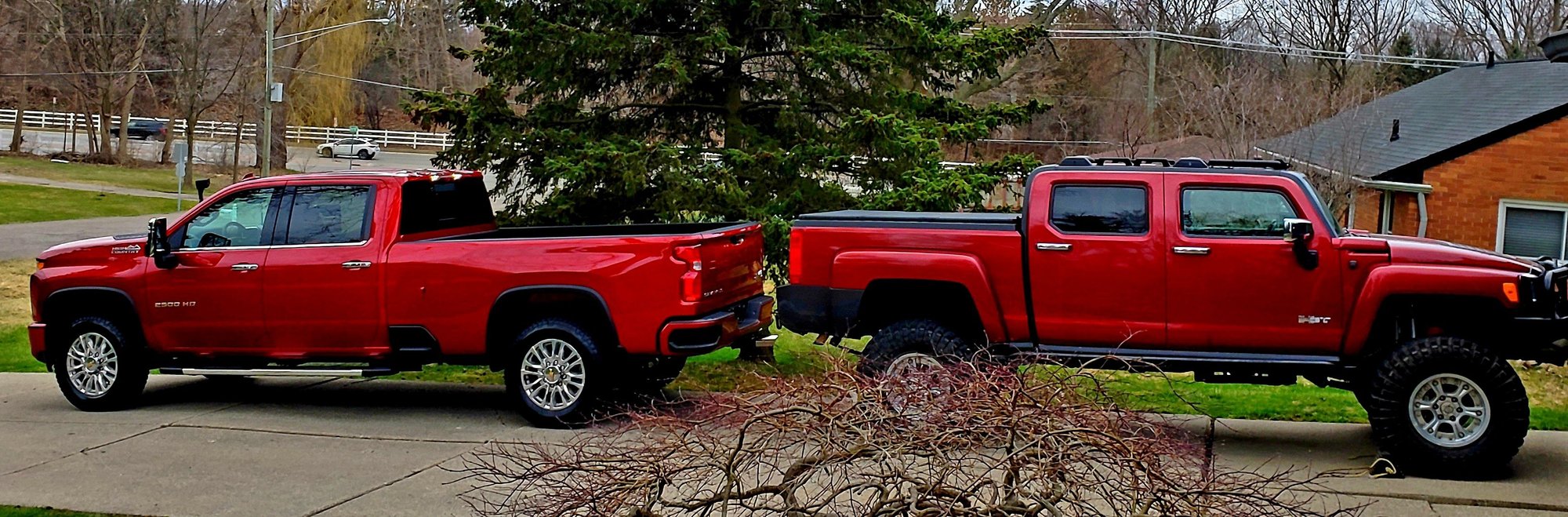

Tainter,
Both of your trucks look terrific! Red is a great color choice for them. Thanks so much for sharing! You live in Michigan, don't you? Enjoy your day! Golden Hurricane
