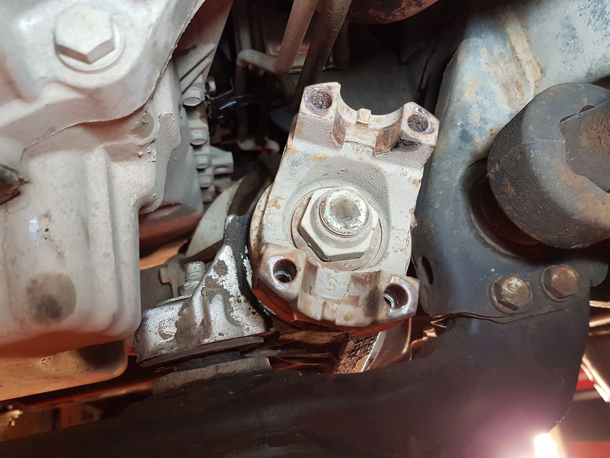

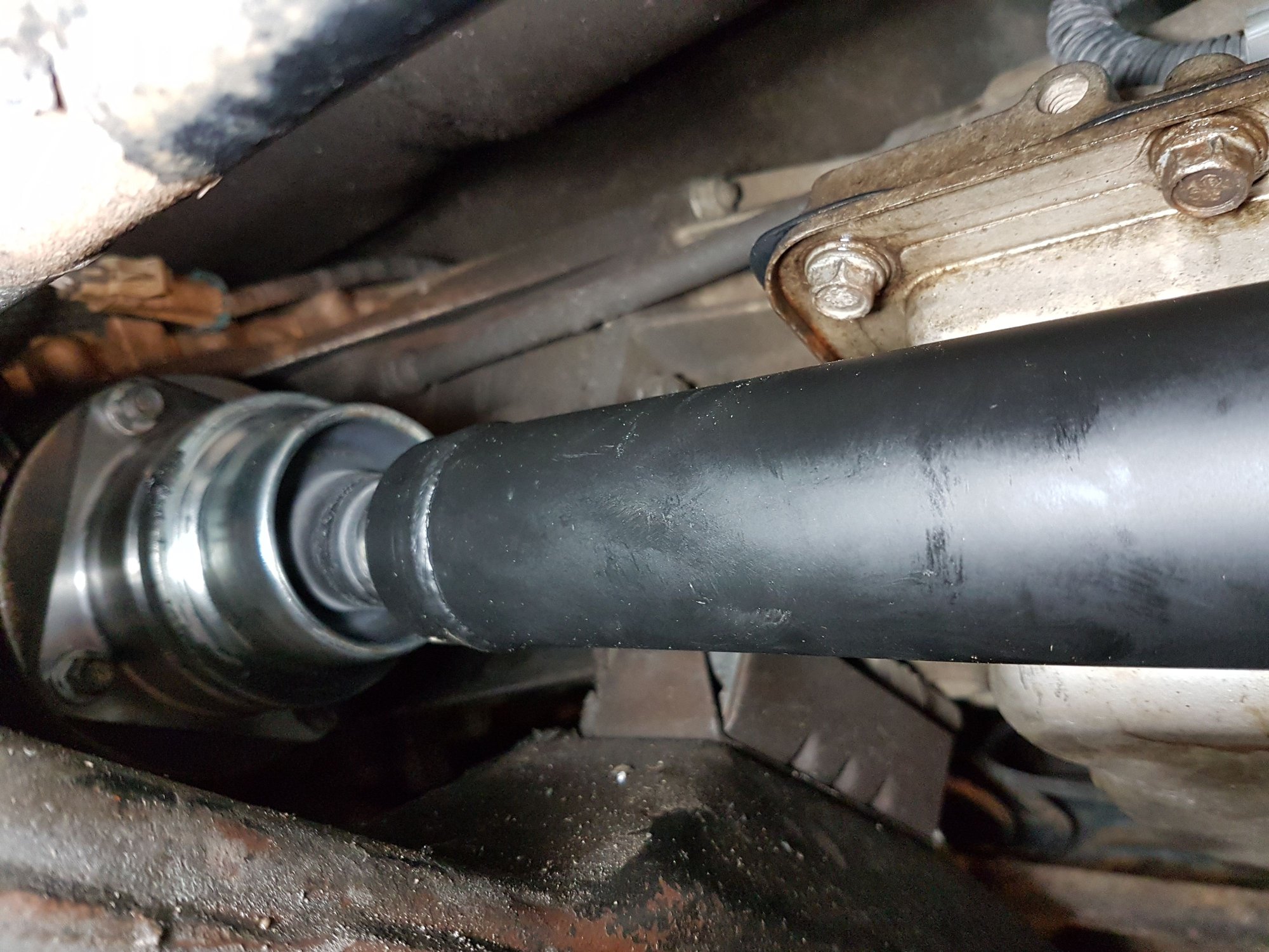

Can you please post pics of your removed drive shaft project?

Old CV Joint was clicking, boot was cracked and bearings failing.
Front UJoint Position
Rear CV Joint Position

Thanks for those pics...
The problem that can occur with regard to the shift fork is the plastic fork can fail. There is some details on this if you use the search feature. There is a fix replacing the plastic with a metal fork.
