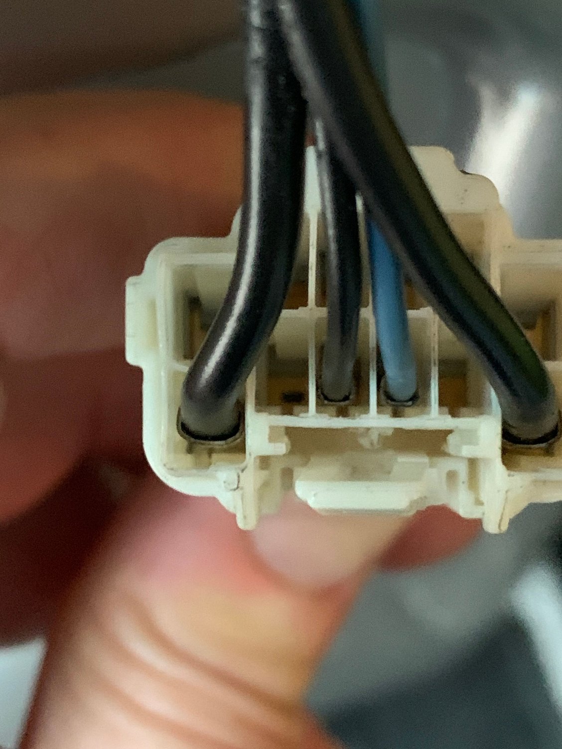

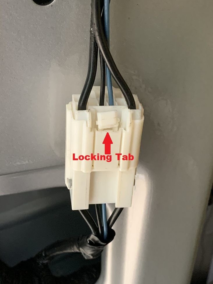

Old Aug 17, 2021 | 01:23 PM
Posts: 13,096
Connectorology: OR... pushed together then squeeze the release while doing the disconnect.
Old Aug 17, 2021 | 03:58 PM
Posts: 9,012
Connector locking tab looks distorted. Simply insert a thin blade in the slot, to release the tab.

@Hummerz - I did try it with a small screwdriver in behind the tab to make sure it was disengaged, but that didn't change anything. The distortion you see is from trying to "gently" pry the parts apart previously, but being a little too vigorous. As near as I can tell the connector is bound up in the area of one of the thicker wires. I see motion in each of the other 3 corners when gently prying with the locking tab pressed/disengaged. The remaining corner does not budge when I use a little leverage to try to separate the two connector halves.
I've had this specific connector apart in a prior H3 and there was nothing remarkable or tricky about it, but for some reason the one on this new truck is not cooperating. I suspect its something sticking in the metal connector pins. I've tried squirting some CRC QD Electronic Cleaner down there, but maybe I need a different solvent/lubricant?
