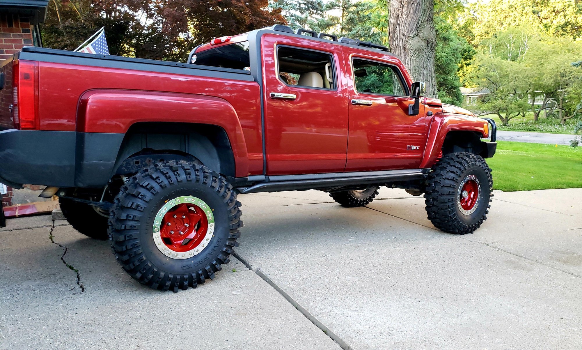

Old Dec 5, 2024 | 11:29 PM
OFFroadMonster's Avatar
Posts: 37
From: Colorado Springs
Your truck is beautiful.
Thanks for the response.
