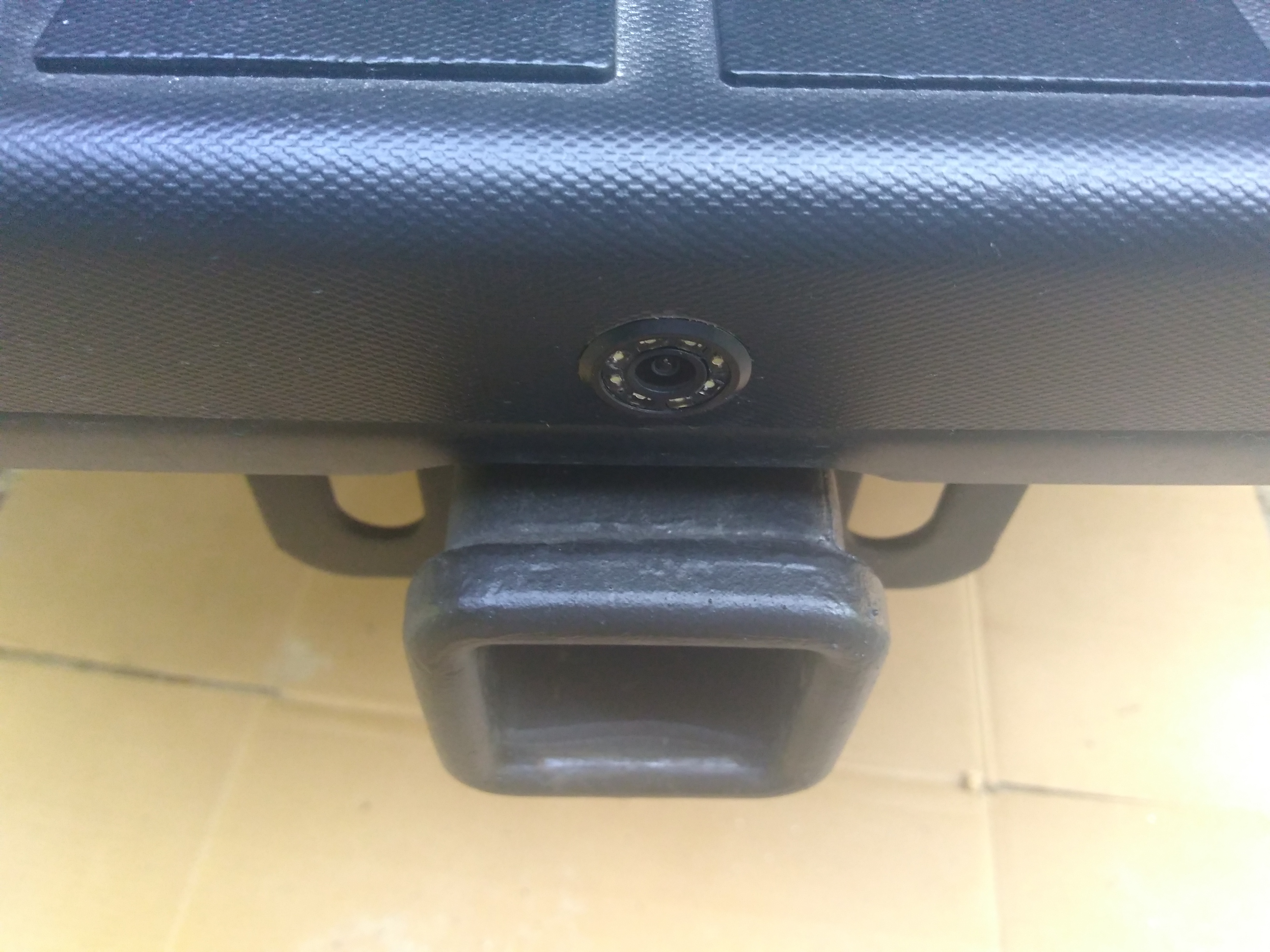

Hi All,
I will be installing the Pumpkin AS274B-08A into my 2007 Hummer H3. I did custom installs for over 20 years using brand name equipment.. This is the first time I am trying an off brand.
I got the unit yesterday from Amazon and read the manual and looked at everything it came with.. I thought I had purchased everything I needed for the install but right away I saw the ISO Plug on the main Power / Speaker harness. I am not a fan of cutting of manufacturer plugs. So I found the correct matching ISO plugs on Amazon. Now I have to wait two more days to do the installation.. So I will start with the backup camera, GPS Antenna, Etc....
I installed a CCD Night Vision Rear View camera into the center of the bumper. I removed the rear left interior panel and connected the cameras power and ground wires there to the Green - Positive and Black - Ground of the reverse lamp. I then continued running the video cable up the drivers side under the panels.
Attached Thumbnails 2007 Hummer H3 10.1" Android 8.0 Head Unit  Installation-img_20180822_102821951.jpg
