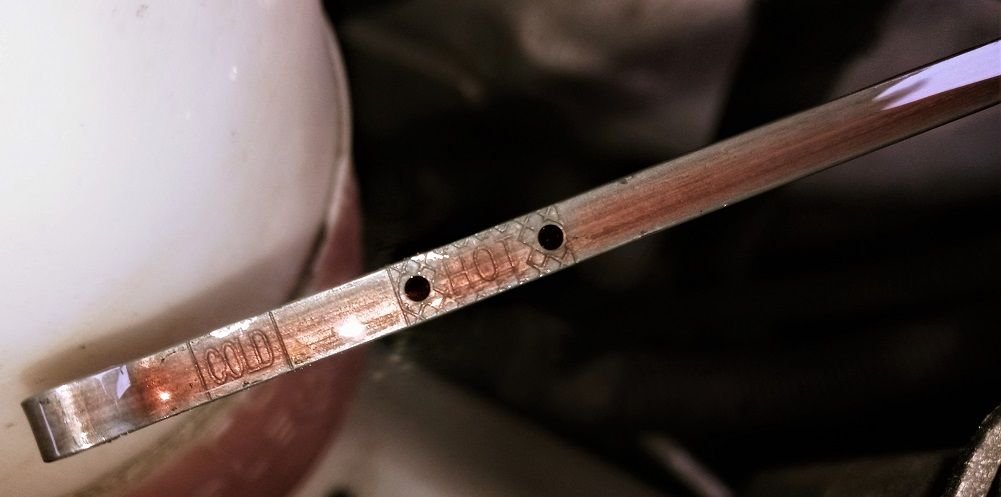

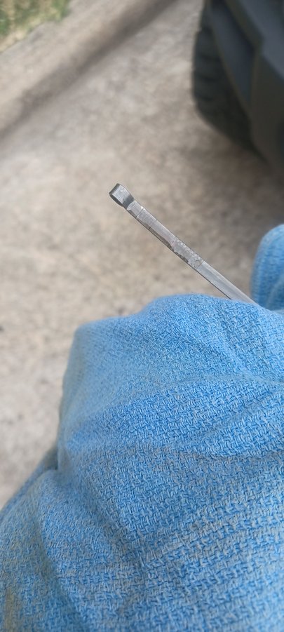

Sorry for the late reply. I been offshore for work in the gulf im getting back tonight and checking the truck soon to keep u posted and also pic of the transmission fluid

Old Apr 20, 2022 | 05:52 PM
  #26
Posts: 9,017
Originally Posted by Alex DjFlaco
Not a clear picture!
