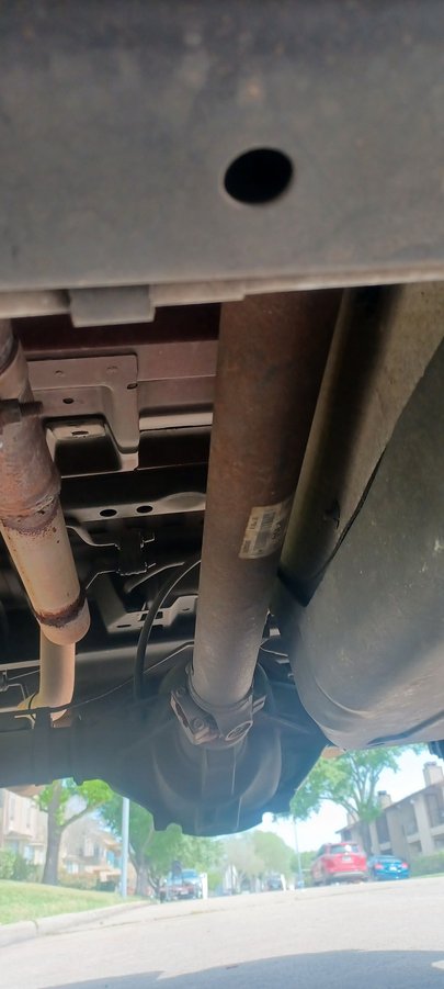

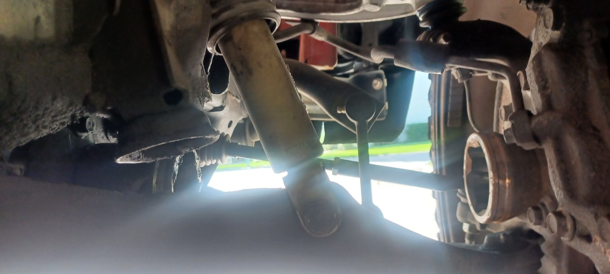

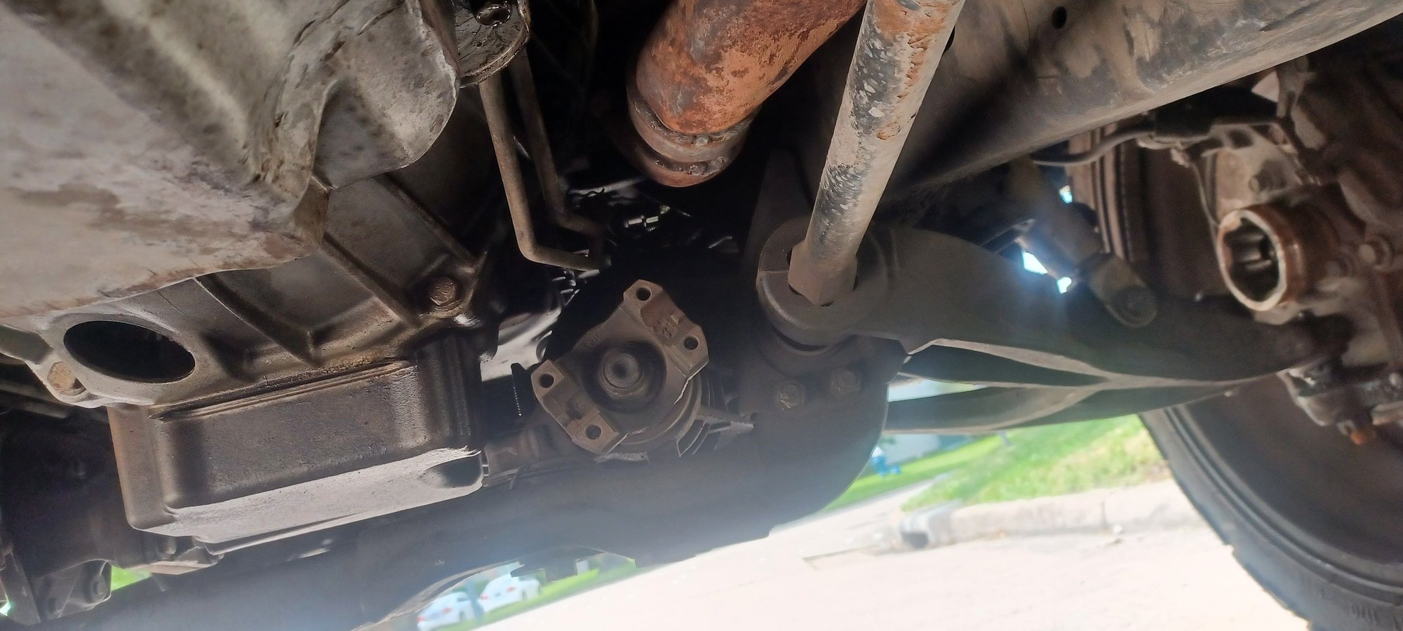

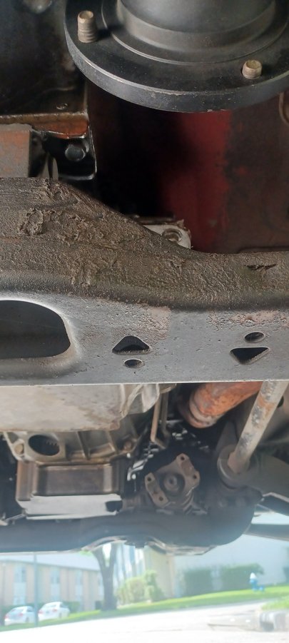

I was driving down the highway at about 60mph and out of no where I hear this bang under the car and then my car started to decent it's speed by its self. I had to pull over and get a tow truck. My car dont move forward or backward nothing. When I try to put it on drive I hear a noise and same when I put it on park again. I looked under my car and I see something is missing from the bottom that Im not sure if I had it before or not. Here's a picture:
This is under the driver side:
This is under the passenger side:

Your front drive shaft took a dump and is no longer connected to the front diff. Cannot tell for sure from the middle pic, but it looks like the front drive shaft CV is also not attached to the Transfer Case. Has it had vibrations for a while?
Based upon the questions I have seen you ask over time, take it to a reputable repair shop to have the assess what damage was done.
Good luck.

It has 183,xxx miles on it. Also I guess my car had a small amount on and off vibration but I just figure it was my alignment.

was it turned into a rear wheel drive? looks to be missing axles. does it have a transfercase still or does the rear drive shaft come straight off the transmission?

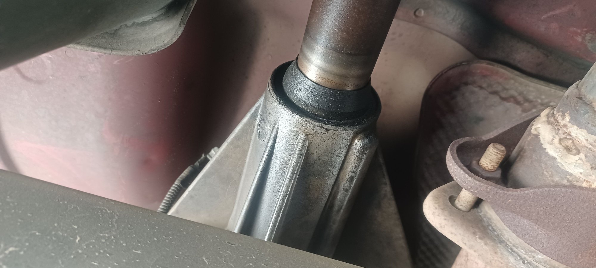

It still has the transfer case (picture shows the flange for the front drive shaft). It appears the transmission has failed.

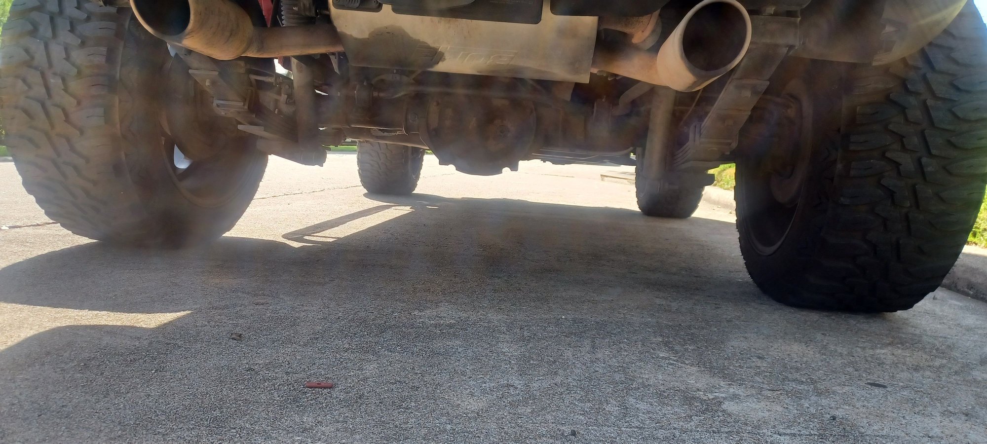

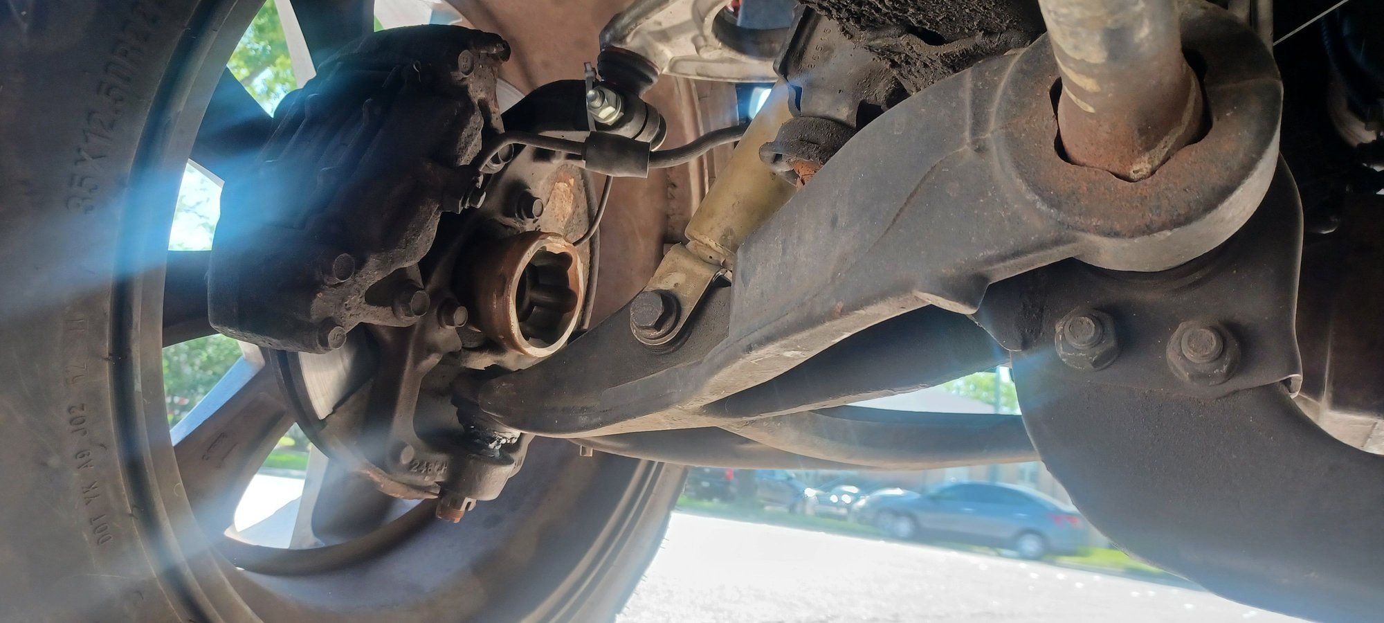

It has no front axles and no front driveshaft. The only way you could have been driving it is if the transfer case was in 4H-Lock.

o ok it must of been that then I wouldn't know because on my dash the buttons for 4h lock don't light up. So what do you think I should do? I guess take it to get it checked out ?
