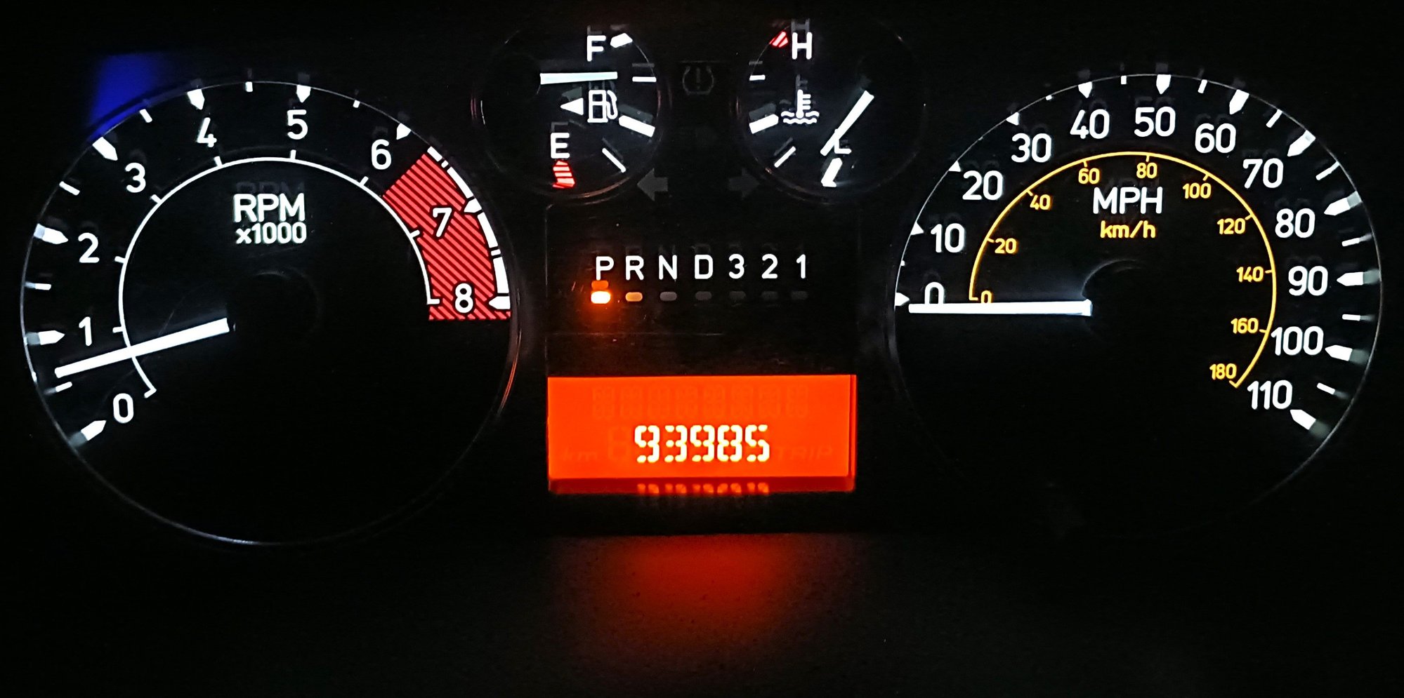

Post a video (with sound) pointed at the IPC showing stable idle then stall.
