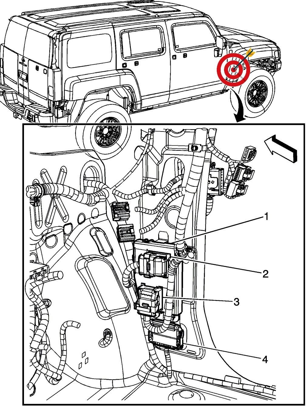

Fix your clogged sunroof drains. Finally, a fix for clogged sunroof drain tubes Google it as well, lots of how to out there. Do NOT ever use compressed air to blow out the drain lines.
Inspect the BCM for water damage, corrosion, harness corrosion etc.... Might need a new one and have it programmed.
