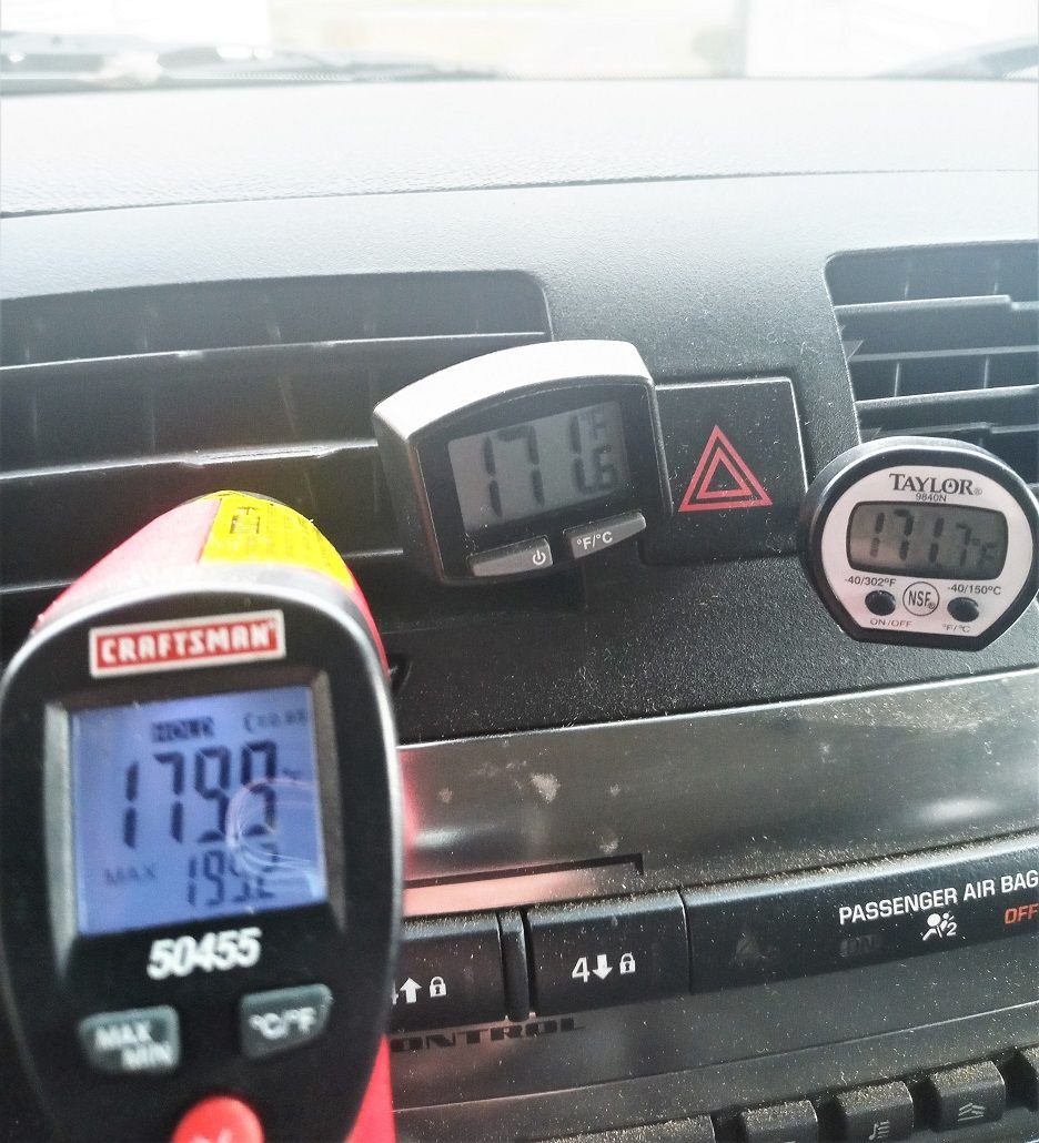

Yes, there are 2 blend doors as noted above, regardless you will not have cool air inside the cabin unless you activate the a/c compressor. 115°F at the center vent is LOW!

Another vent temp check @ 28°F ambient temp. - 195°F coolant temp:
(hotter inside the case)

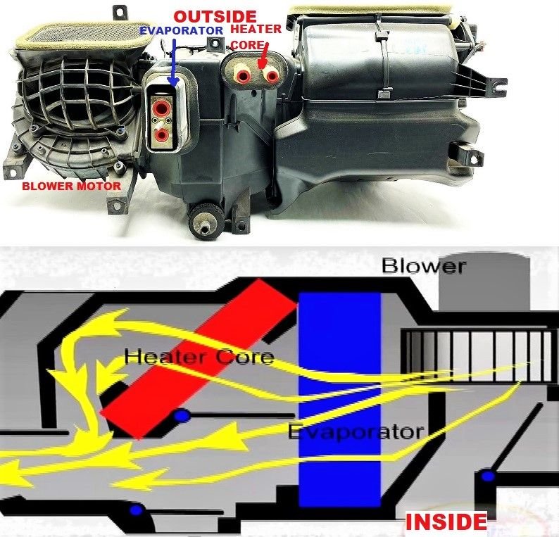

Another image for the H3 picture book.
