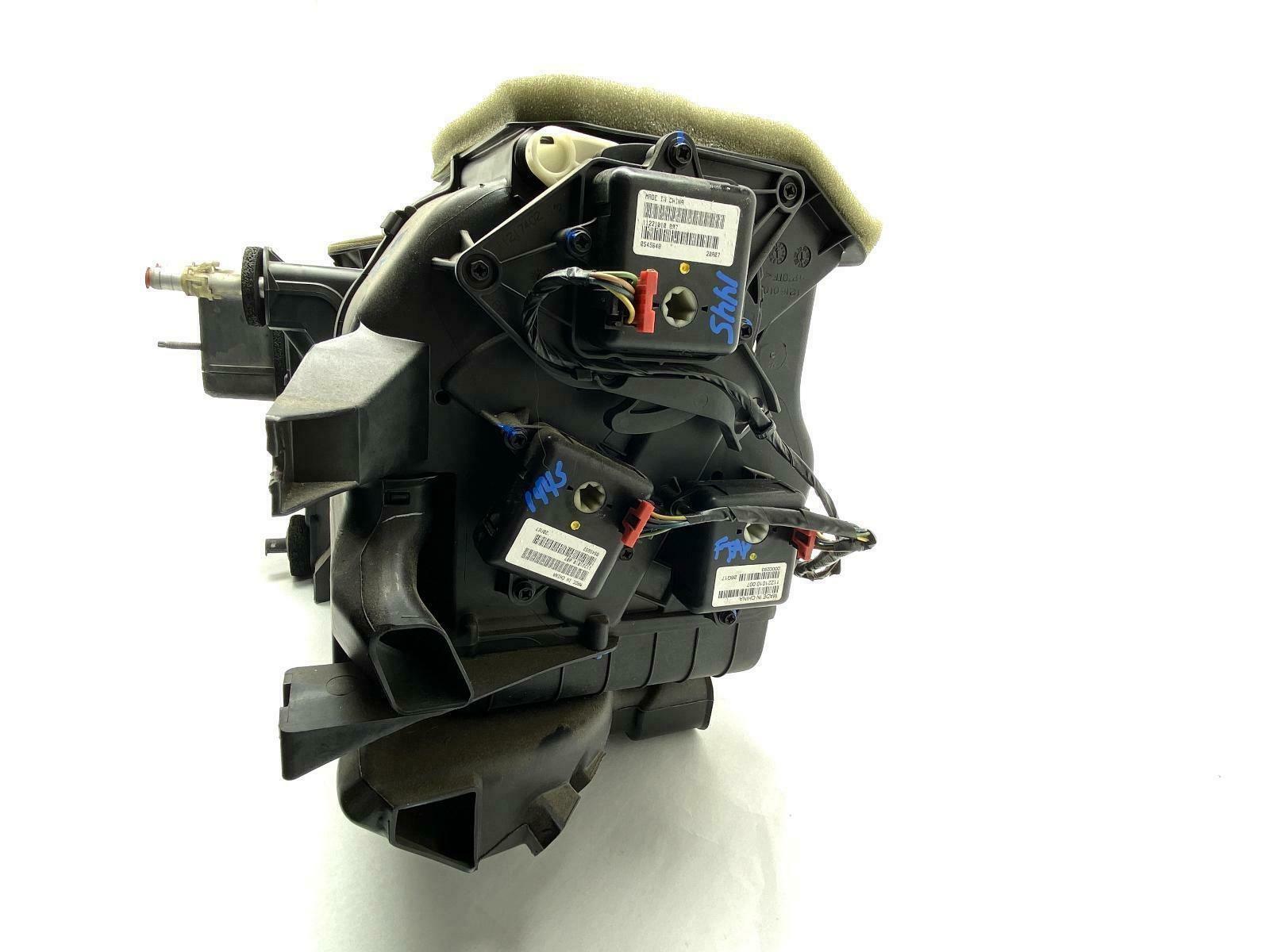

The air inlet actuator valve (#4) should close when pressing the (air-recirculation) center button(pic above). There are 2 temp control actuators(#30) controls air output temp, and 1 mode actuator (#32) redirects air flow (pic above). You're having a 65°F DROP, from center vent to dash vent, doesn't add up? Air flows in the case, look at the right side of this pic (left side inside cabin) and you will see the air always flows to the windshield:

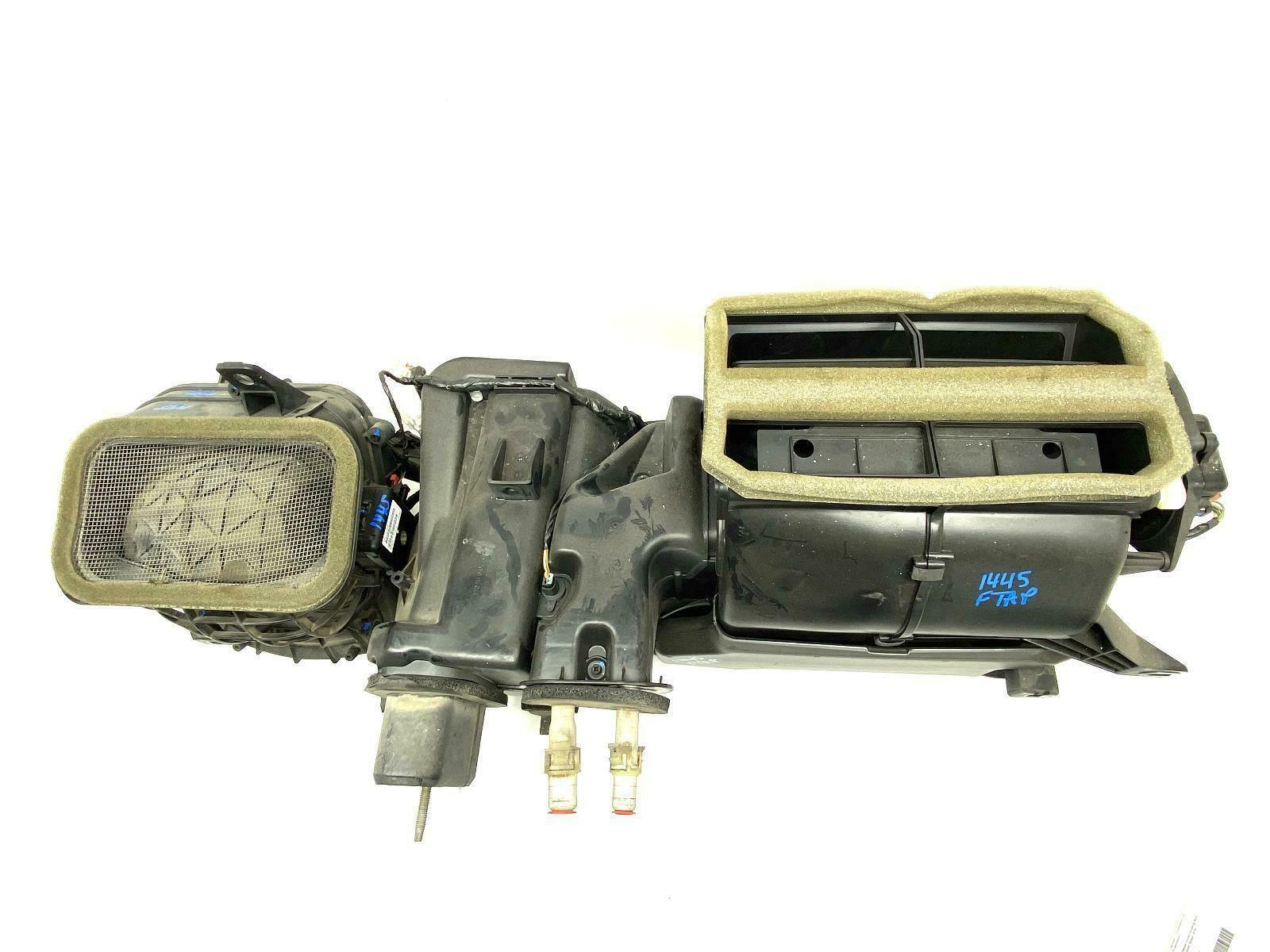

Got the dash pulled and the air distribution box opened up. The door that is operated by the rear lower actuator broke the end post that actually attaches to the actuator drive spline and had fallen down into the box.
GM says the box is a "non serviceable part" and must be replaced as a complete unit. We were able to find 1 and have it on the way.
