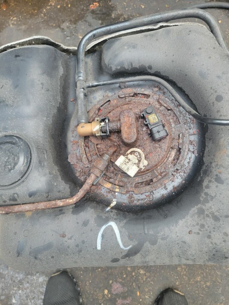

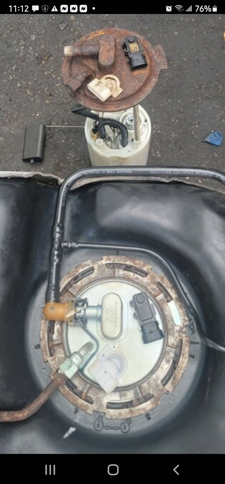

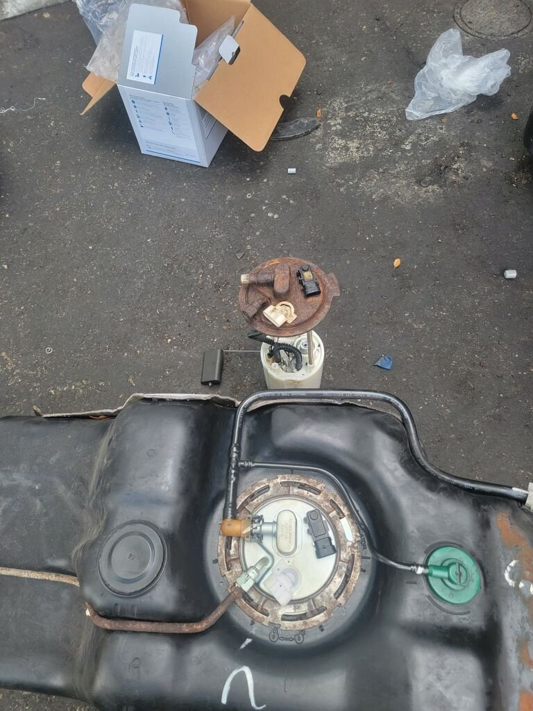

Default Miami 3.5L replaced gas pump
[QUOTE=Doc Olds;392207]You have an exhaust issue. Go to a repair facility that does exhaust work............. like a muffler shop, not a national chain with kids working there, but a genuine local muffler shop that does all kinds of exhaust work.
New gas pump install. Old infront of it.
The old and the new.
Bad gas leak!!!
BTW, there is no such thing as a "seized" O2 sensor, real exhaust shops know how to remove it. They have a torch and know how to use it.
Also, H3 questions go in the H3 section so I MOVED this for you
Old Mar 19, 2022 | 12:55 AM
Posts: 3,204
yes the rotted out fuel pump is very common here up north. you need to check your brake lines as they also tend to be just as rotted if the pump looks like that. they almost go hand in hand up here.
Old Mar 19, 2022 | 05:05 PM

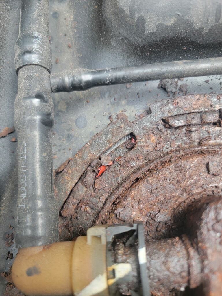

Bad gas leak!!!
HALF-AZZED repair! Reused the the rotted FPM retainer ring & the fuel supply line? The module or line could blow at any given time.
You beat me to it!
Old Mar 24, 2022 | 06:49 PM
Originally Posted by TAINTER
You beat me to it!
Just to save a few bucks?????
Future reference for anyone that replaces the MU1473 FPM (#12 & #13), the lock/retainer ring (#14) NOT included, nor the 25896785 feed/supply line(#17).
