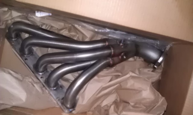

with the 06 it is only one O2 sensor on the exhaust manifold. The One I did was a direct bolt in and worked great. the only issue I had was getting the lower three bolts out.
Here is a pic of the one I ordered and it has two O2 holes, and I only needed one. It took me two days to find a plug for it, and it fell out.
I5 Colorado/Canyon Stock Replacement Header
Here is where I ordered mine and it already comes with one O2 hole.
I also ended up replacing my O2 sensor because it was rusted in place

it specifically says 2 O2 holes, and I know for a fact there is only one
I would think that you could read because I just explained that and tried to help someone that was wanting information.
