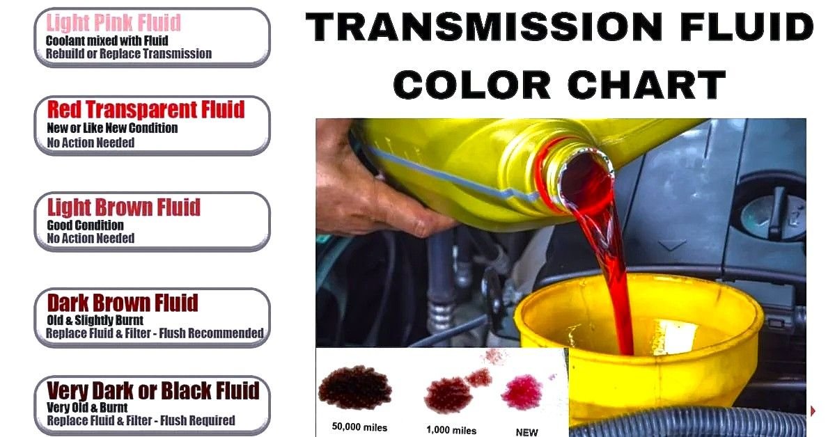

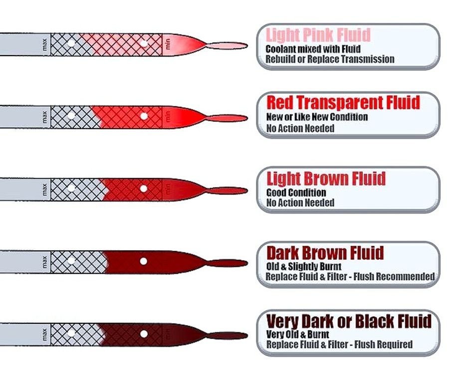

Old May 6, 2026 | 03:12 PM
Posts: 9,015
What color is the fluid?
