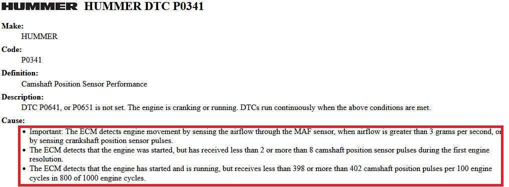

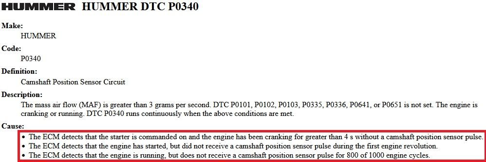

My 2006 Hummer H3 is giving me P0340 and P0341. I have changed both sensors and still giving the codes and it has already damaged 4 stater motors. Any ideas on what could the problem be?

The starters were never the problem.......... and what "sensors" did you change. Did you try to skimp with off brand El Cheapos because they are cheap for a reason.
Verify the wire harness and connectors to the sensors are not compromised by fray, cracks, rubbing to other surfaces and use CRC Electronics Cleaner on the connectors.
