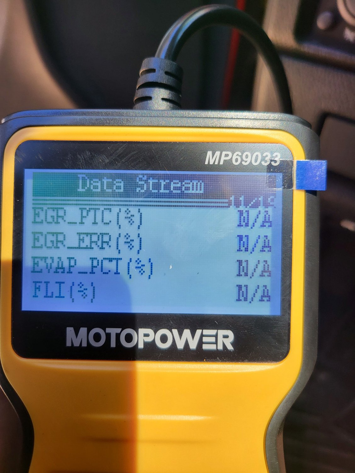

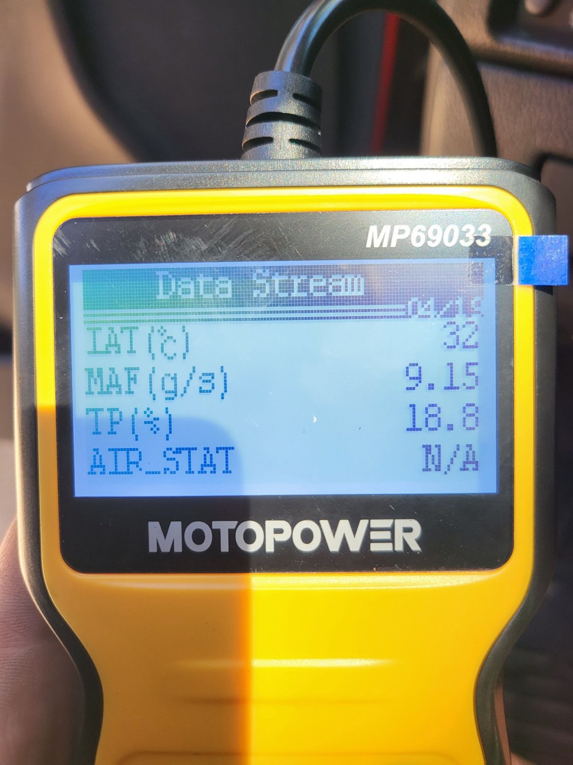

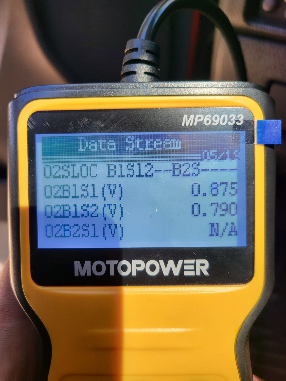

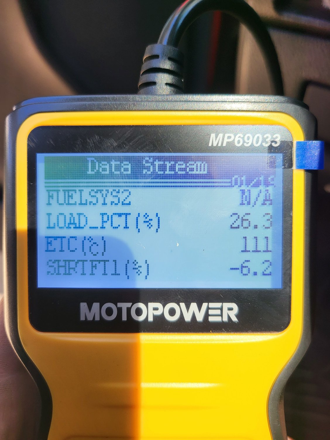

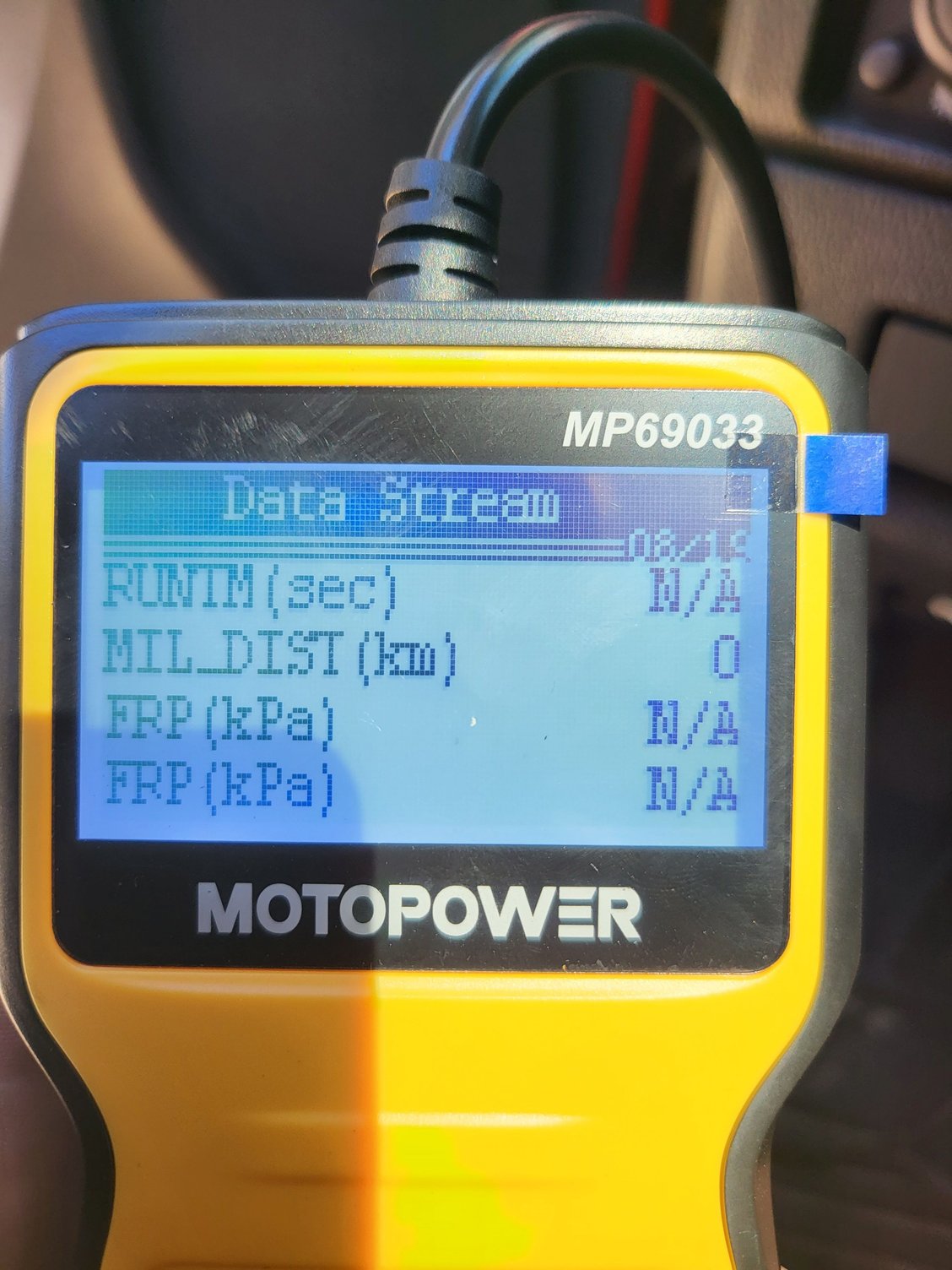

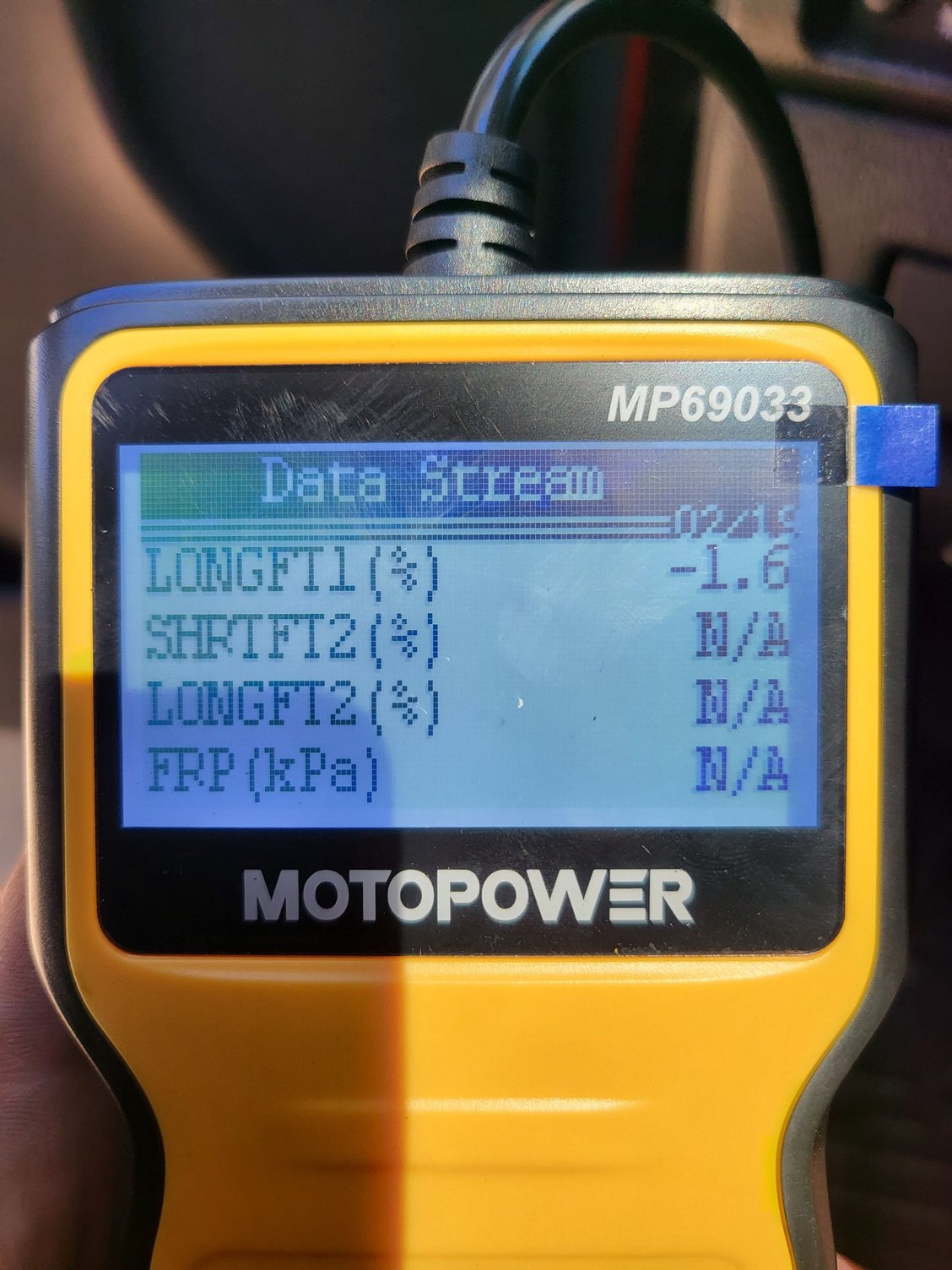

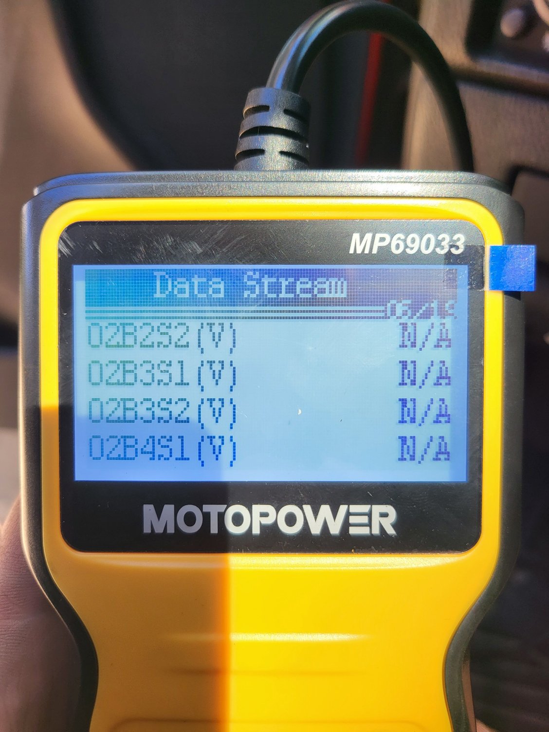

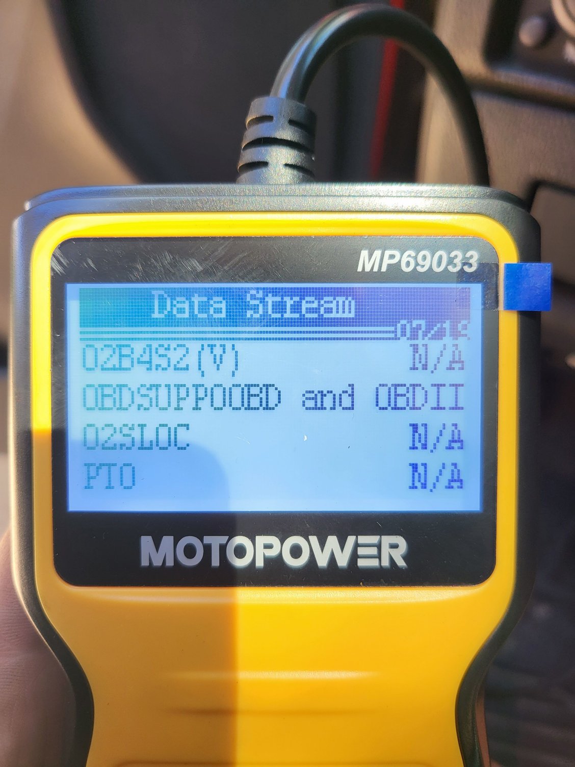

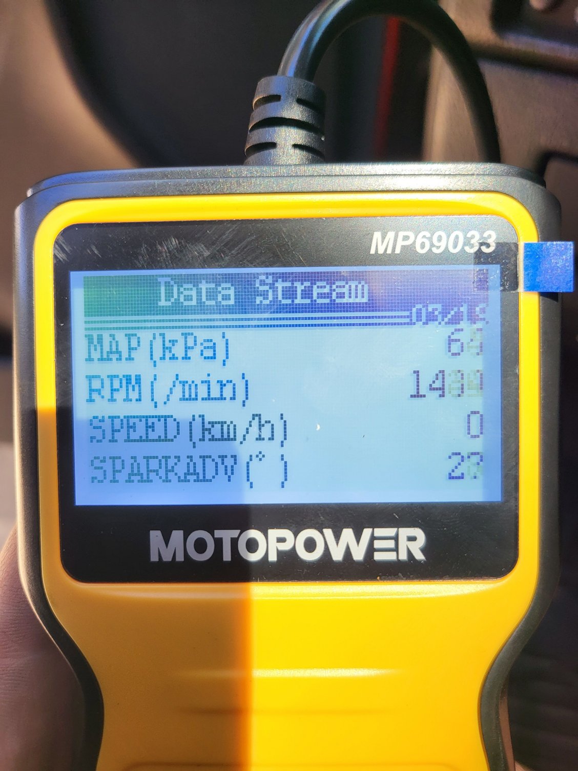

this is the data while running above idle so it doesnt stall and getting p0106

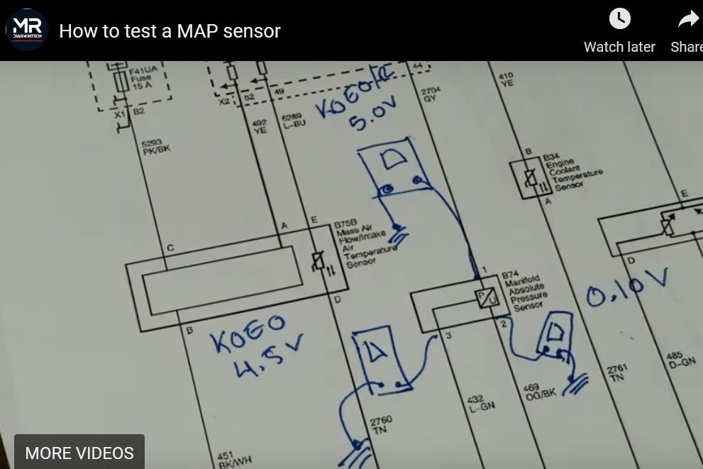

The first step of voltage testing:
Old Jul 12, 2022 | 02:06 PM
Posts: 3,206
one of the pins should have a ground and another should have 5 volt reference on it. see what is missing at the harness plug. a low battery can have issues allowing the ECP /PCM from generating proper 5v reference voltage supply.

Did you watch the video above and back probe the wires?
